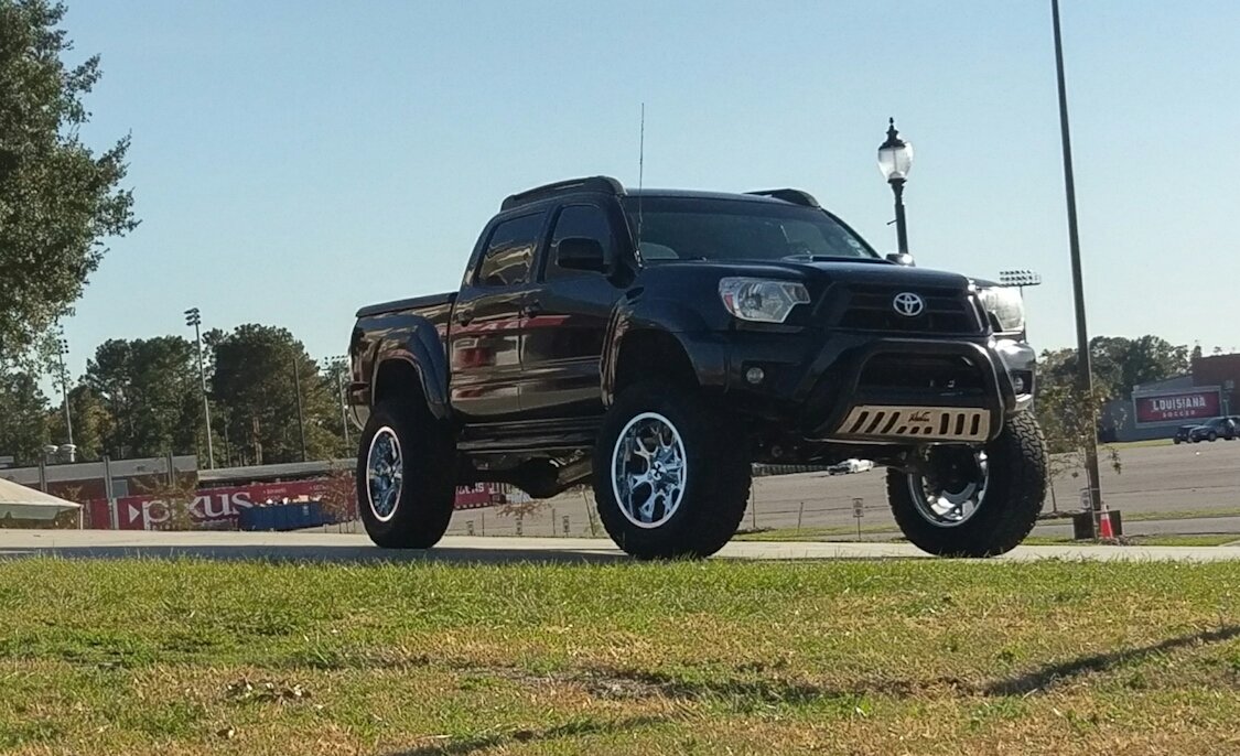

    Me too :) Same setup, 3" coils, 4" MaxTrac'S, run 35x12.8's

    Good point, I had to get new wheels, that's an expense alot of folks forget to factor in. I got the whole MaxTrac kit from a buddy who bought the kit and traded in the truck before he installed them. $250 brand new in the boxes hehehehehe :)

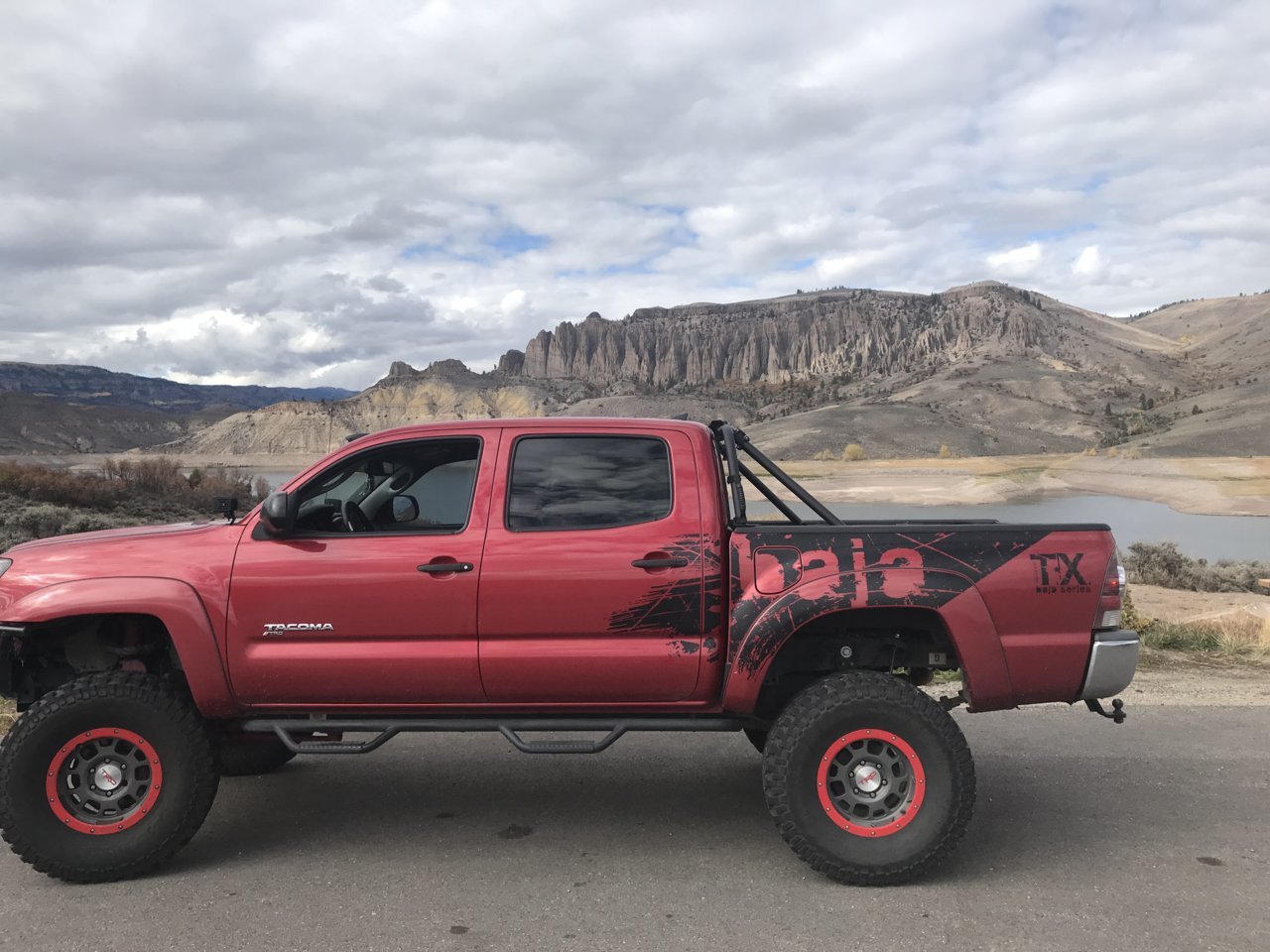

    I’m running 16x8” wheels with 4” backspacing, and 35s with Maxtracs, you can see pics on my build page. Nowhere close to touching or rubbing anything. Can provide additional pics per request if needed

    Hell yes! Lookin good bud!

    Did you use spacers cause method wheels have a 0 backspacing which wheels did you use

    I will not run hub spacers, seen to many failures so I don’t trust em. I am using level 8 mk6 wheels. And the stealth custom series wheels also come in negative offsets and work great as well.

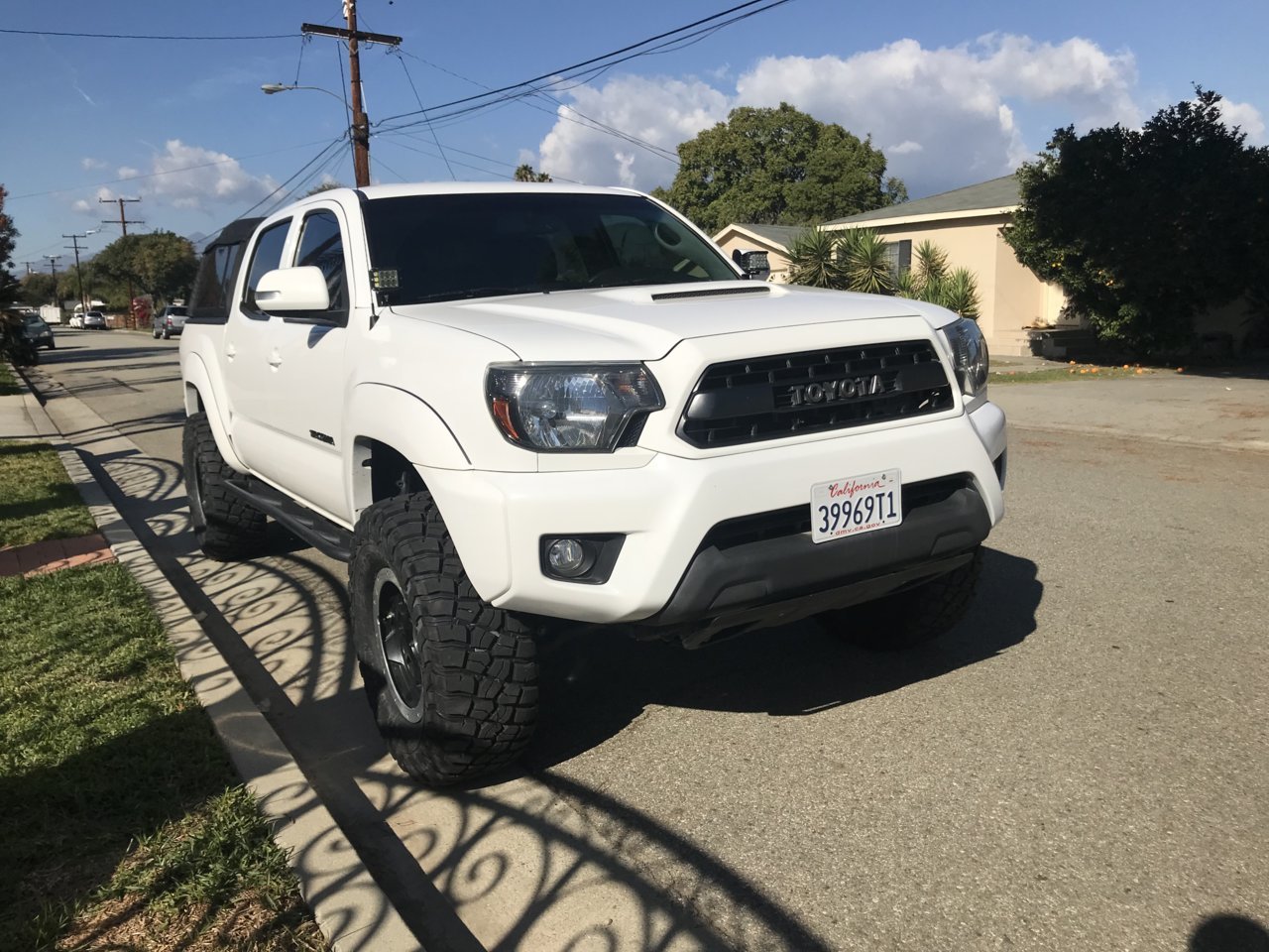

    This is great feedback, appreciate the help. Just kicking myself now for not going high enough for my personal taste in the first place. However, seeing the 3" with 35s gives me hope.

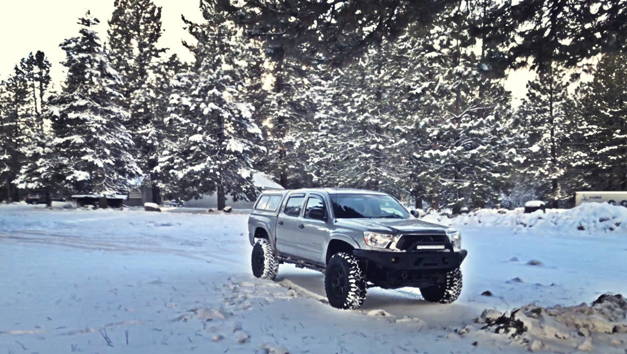

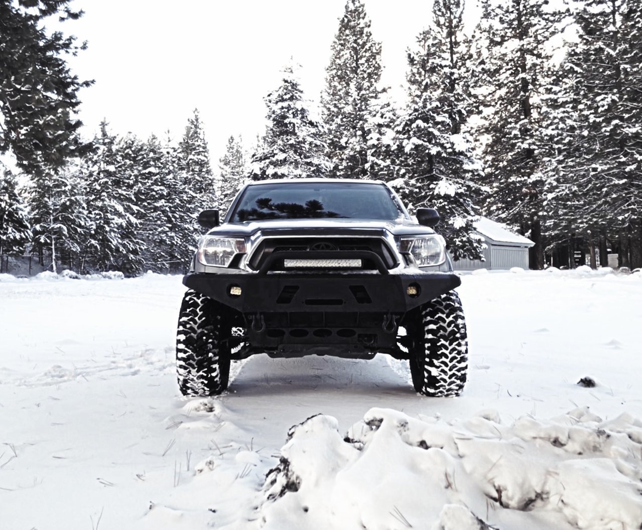

    This gives me hope! That thing looks mean, love the stance.

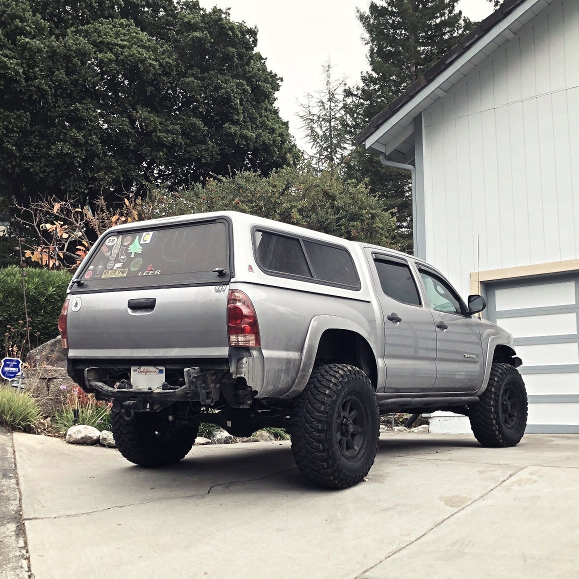

    Now that's a well built rig.

    Thanks. It’s definitely on a budget. Just 5100s w/ 620# springs in the front, AAL in the rear. I have things I’d like to do with $$$ lol.

    I’m rubbing on my cmc for sure off-roading. Fenders and frame haven’t seen any rub yet.
