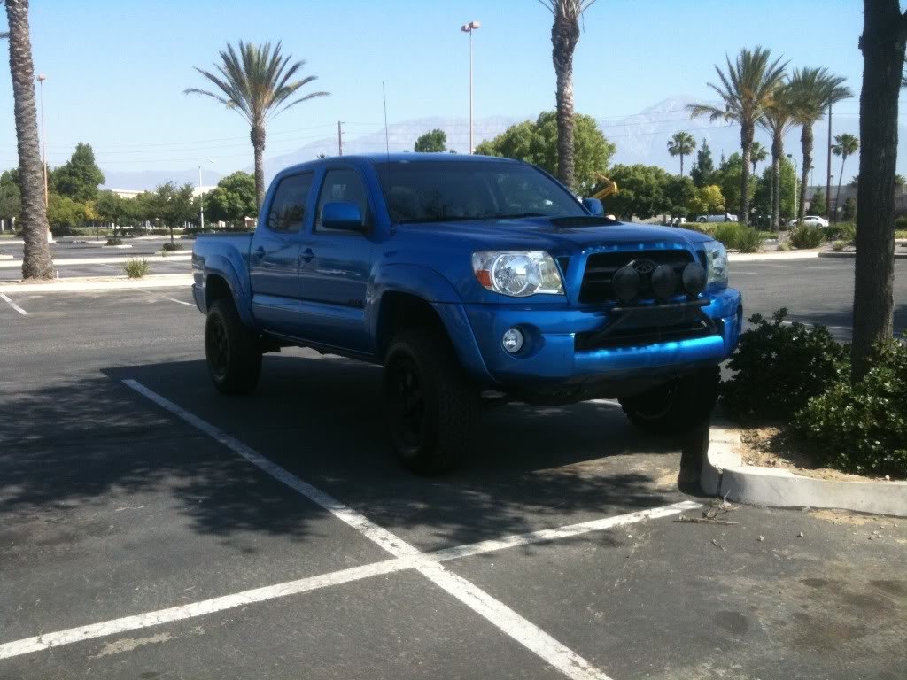

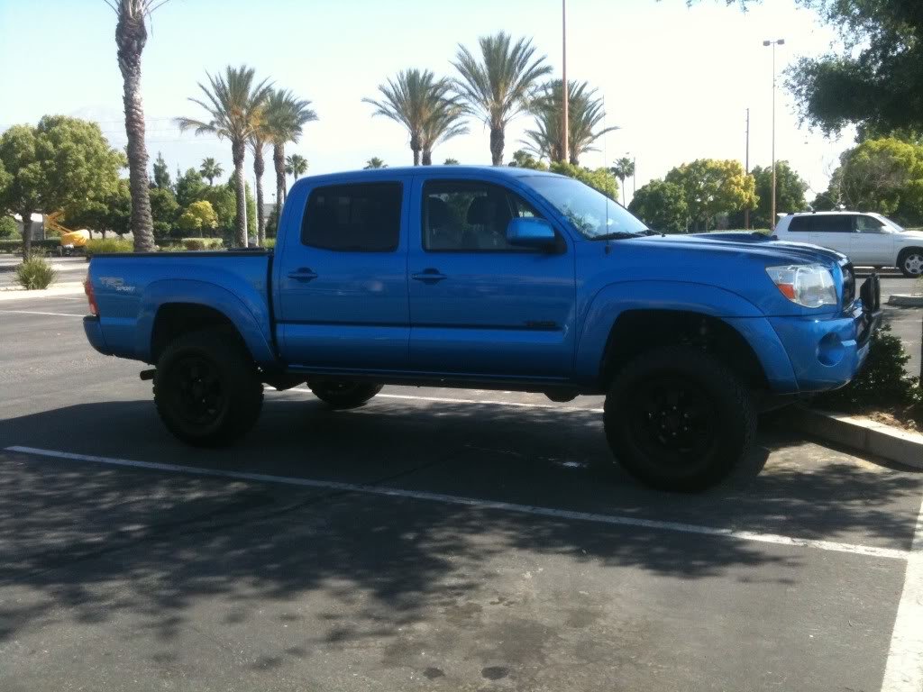

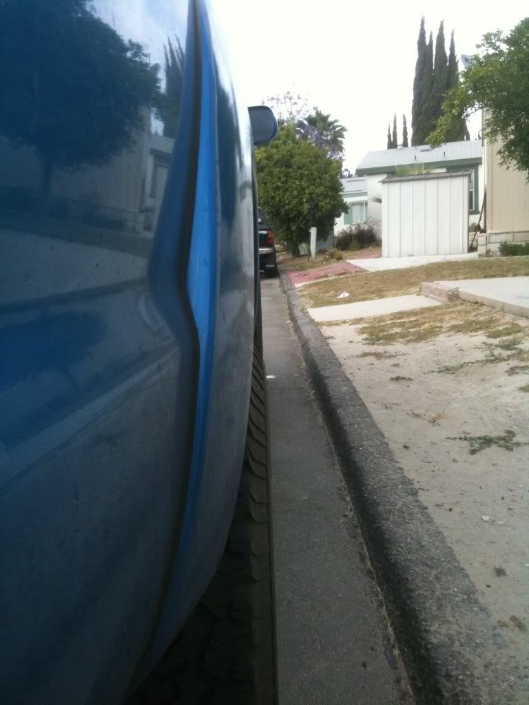

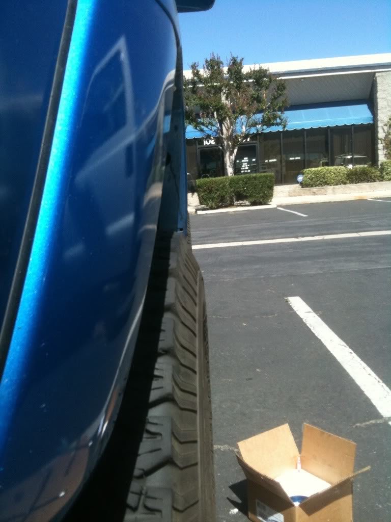

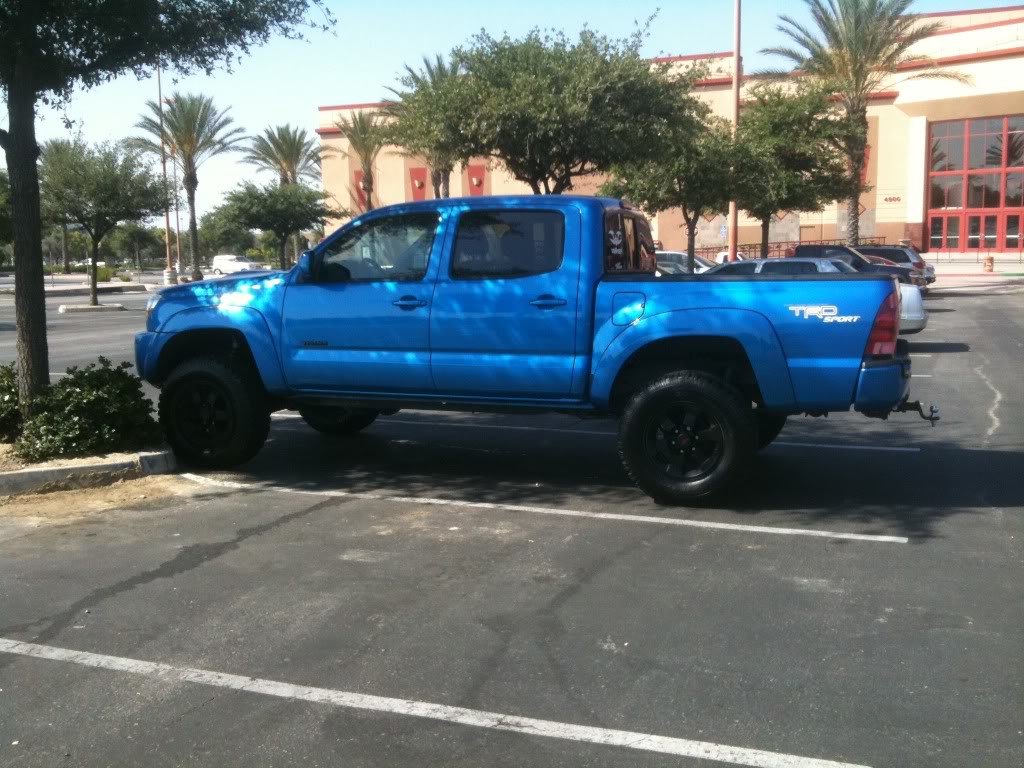

    265/75/16 is not the stock tire size, however if you look up ColtsTRD, he is lifted 3" w/ 265/75/16
    If I were you I would just get some Eibach Coil Springs and some Bilstein 5100's, thats what I am going to do. Already have my 265/75/16 Duratracs installed with no rubbing on stock suspension.

    Here is a pic of his truck.

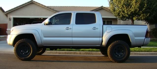

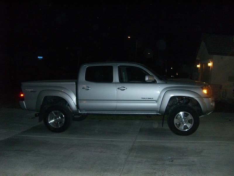

    3" lift...First pic is the night I brought it home after the lift was installed so the front springs hadn't settled at all.
    Stock tires - 265/65-17
    BFG Mud Terrains - 265/75-16
