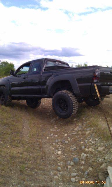

    3" lift with 33's would be a better choice like others stated. x1000 on not getting 20" wheels especially if you plan on wheeling, but its your truck do what you want but you will get flamed if you ask for opinions especially from people who do wheel and have the most ideal set ups that work re: 16", 17" wheels are better for obvious reasons, more rubber equals more traction, able to air down more etc..... if you do get the 20" wheels and do go wheeling and find out they may look good (to you) but they will suck for wheeling, you cant say that you were not told. :D I have a 3" lift, 285 70 17 km2's. i had to trim my plastic, pinch weld mod, and cab mount chop to get rid of any rub at all positions. below are pics of a simple ditch i used to gauge how much i had to trim, kept trimming until all the rub was gone. i was able to position the truck at all angles until uptravel and downtravel maxed out and trimmed away in the front.

    Thanks for the pics 907! I've said that i'm probably going with 18's or 17's, so now i'm just looking at which tires I should go with.
    How much did you end up having to trim with the 285 70's??

    had to ditch the mud flaps, standard cab mount, re tested, had to do the pinch weld mod, easy to do. unless you get a CBI, relentress, arb, etc........ front plastics on fender liner need to be trimmed. I can take pics of the pinch weld later if you need to see them.
