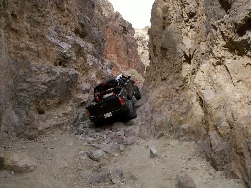

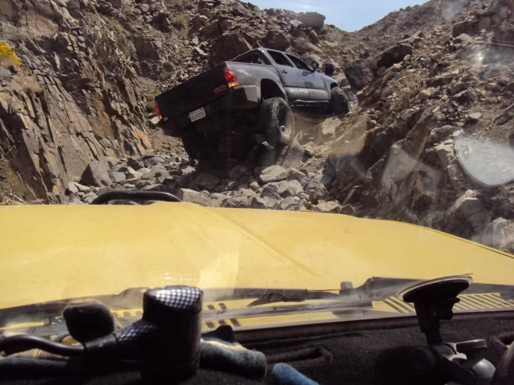

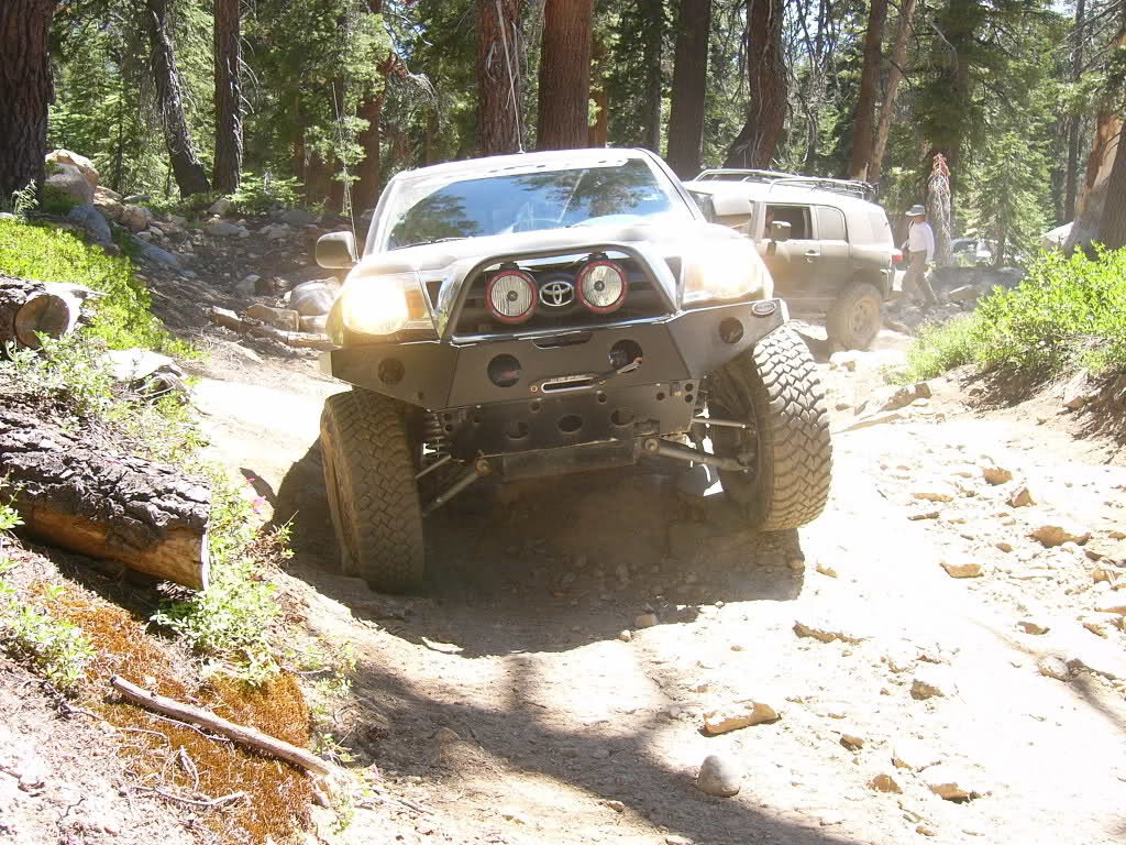

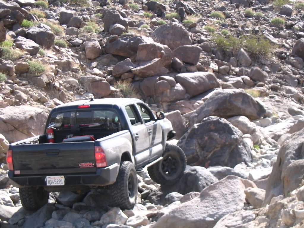

    want to do extreme trails..get a rock crawler!
    worried about rubbing, scratches, dings, dents, sheet metal? get a rock crawler!
    want something for looks? get an actual Long Travel Kit..there are several great options out there to choose from..i bet there are not too many LT taco's in your neck of the woods and would end up being a rare and exotic, people drool over that stuff!!
    just from my experience with being on the trail with DB equipped taco's...there is no ground clearance in the front! the drop bracket gets hung up on rocks or whatever..then they have to get strapped or pulled out with a winch slowing the progression of the whole trip on the trail.
    i have taking my taco to the limit and beyond, and now paying for it.. from cracks in the frame, cracks in cross members, cracks in wheels, broken rear ends, smashed exhaust and drive shafts... etc ect ect... all due to the fact that i wanted to do the more extreme trails, i should have bought a rockcrawler from the very beginning!..
    not a single DB lift that is able to take this line!
    no DB lifted truck will be able to get through here without getting hung up!
    wont be able to make this section either with out a strap!
    look at all that ground clearance, LOOK AT IT!..... don't be jealous! :D
