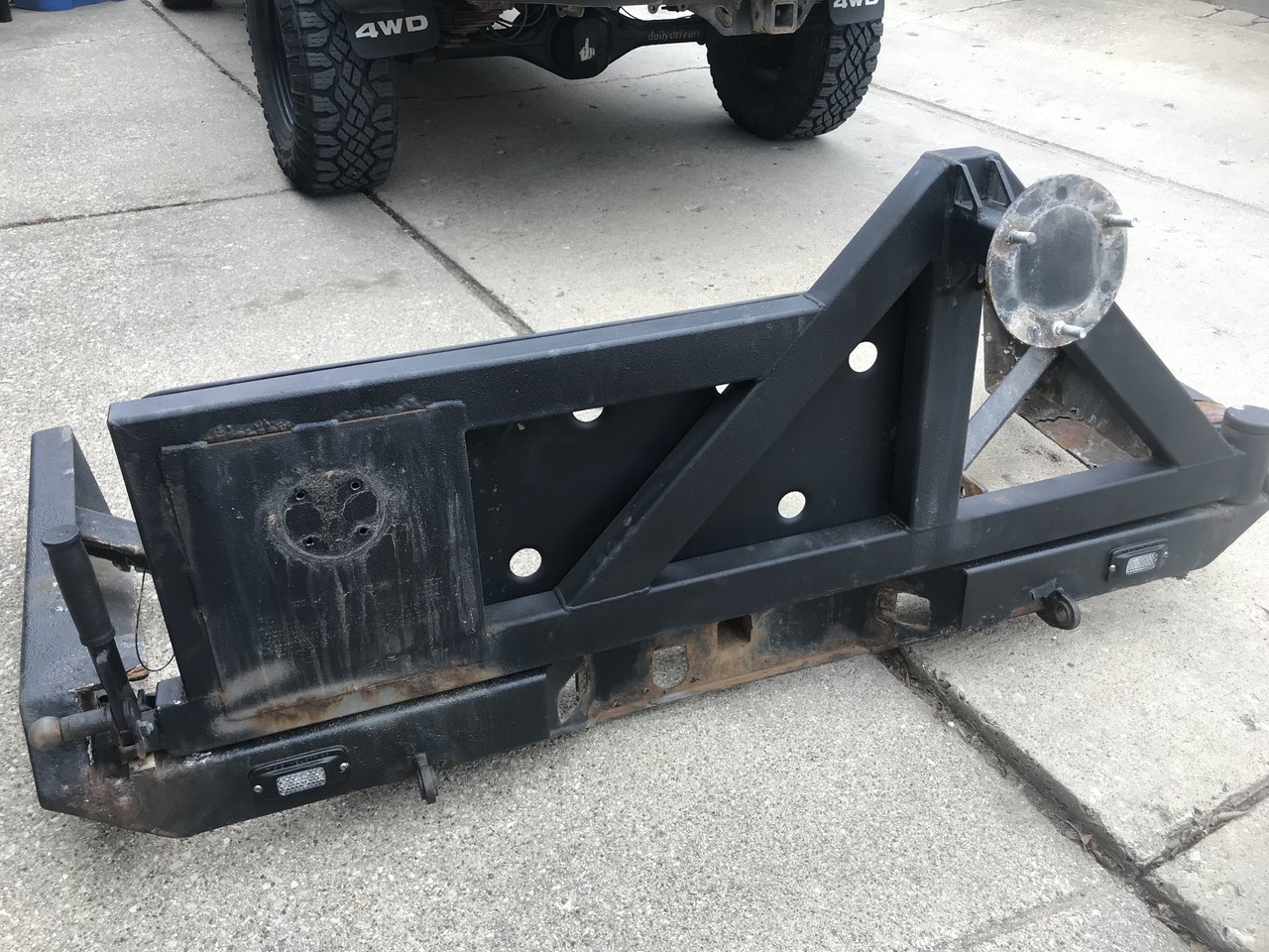

    Got one waiting for some love and affection and then she's going on:
    I have a shell too. I suggest getting Dakars with the D29XL AAL for the extra weight. ESPECIALLY if you're going with a steel bumper like me
