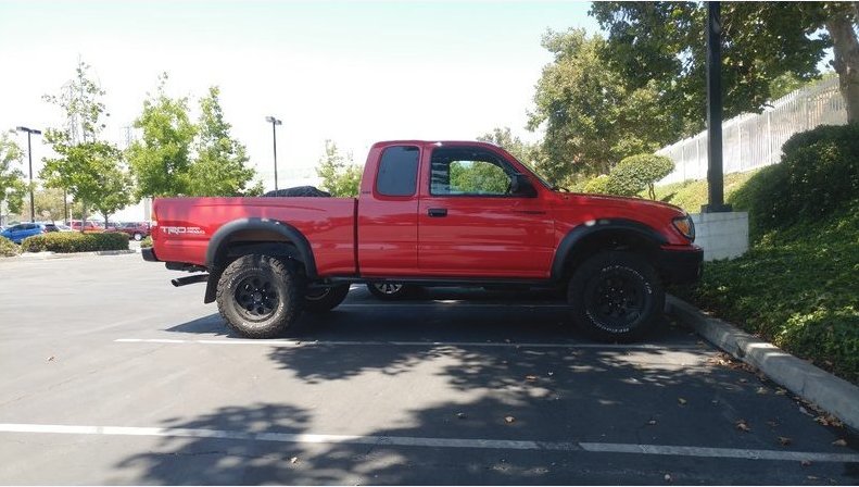

    Not quite 3" (front only about 1.5") but just got my kit installed last week.
    5100s all around (fronts set to 0"), OME 881s w/driver side 1/4" spacer, Headstrong 3 leaf AAL in the rear w/factory overload retained.
    YotaDan likes this.

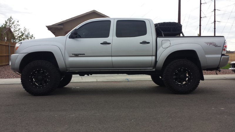

    5100's set @0 with 887 springs and 1.5 AAL. Satoshi Raptor grill, Halo Projector led Spyder headlights and syder taillights, Projector led Halo fog lights by Zack/Taco Nation, LED's everywhere else, Raceline 16x8 Assualt wrapped with Goodyear DuraTracs 285/75/16. Wet Okole seat covers, Paracord headrest handles by Cole/Dessert Dunes, Weather tech floor mats, JVC Arsenal KW-V200BT, 2 10" Kicker shallow mount, Alpine components, Alpine 1000 watt amp, interior is completely Dyna matted
    1st pis is with single AAL
    2nd pic is with 3 leaf AAL

    Looks level . U measure em and it's about the same ?
    It sits level now, rides/handles better and it don't squat like a female dog when I hook my boat up to it.
