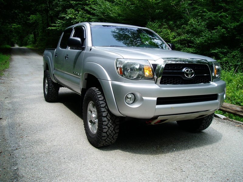

    my 2011 with the toytec based 5100s and AAL I'm running stock uca still with 33x12.50 tires

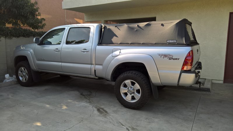

    finished my install yesterday. Got nearly three inches with 885s and 5100s, prerunner. Thanks headstrong! 1.5 inch aal out back.

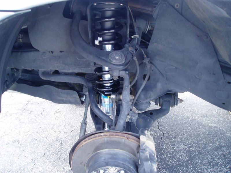

    Keep in mind that with just about any suspension lift, you will get some settling as time goes on. Miles and amount of suspension flexing will speed up the process. I did a 5100/885X/Deavers 2" AAL lift back in March. It netted 2-3/4" (front) when I did the install. In a couple thousand miles, it was down to just under 2-1/2". I went back and added 1/2" spacers since then, and now measure right at 3" above stock height. Rear is holding @ 2" above original.

    Those look like stock UCA. How much adjustment did they say yo had left? I especially like the fact that you had enough that it seems most people that have posted in here have stock UCA. This thread may have just kept me from spending an extra $600

    Stock UCA's.....I got 2.9 degrees + caster and still had adjustment left. The higher you go, the more caster you want. The bigger the tires, the more caster you want. 3 degrees positive is the target with a 3" lift. Most cases, you can't get that much with stock UCA's, but I got lucky. 1.5 degrees is the bare minimum. With that, you'll find the front end wants to wander at highway speeds (and a 2-1/2" to 3" lift)

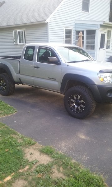

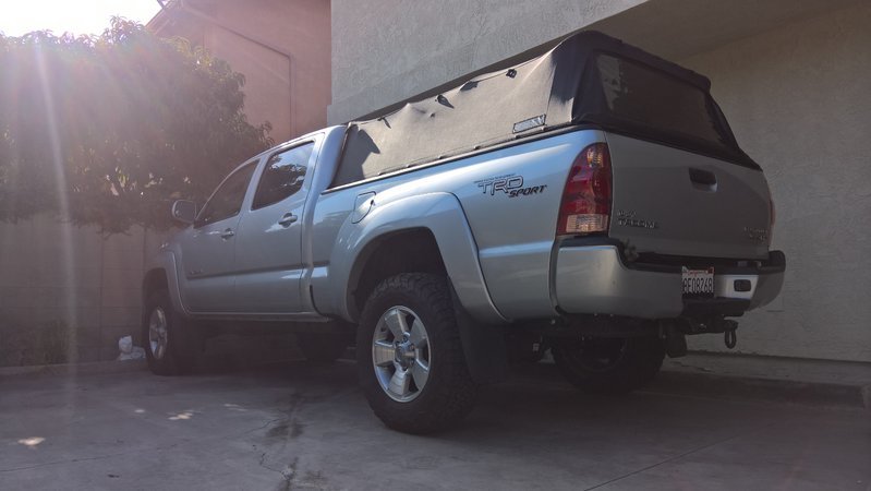

    I've just added 5100's all around w/ 887's. Currently a little rubbing of driver side tire. I'll be adding a 115lb front bumper soon. Concern is the rubbing will get worse. Considering adding a plate spacer to compensate...thoughts??

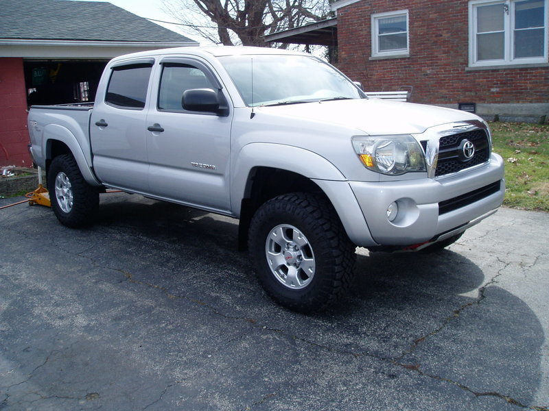

    Bilstein 5100/ OME 887/ 285/70/17 BFG KO2/ 17" ProComp 7032/ OME Dakar/ LR UCA/ Superbumps/ AllPro Flip Kit
    Bilstein 5100/ OME 887/ OME Dakar/ LR UCA/ AllPro flip kit/ SuperBumps/ 17" ProComp 7032/ 285/70/17 BFG KO2

    Looks awesome! What tires and rims you running there?
