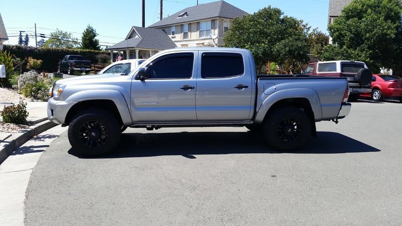

    This is billies at 1.75 on stock coils. Nothing in rear. 265/70/17

    For crawling not hauling
    OP - do this. Cheap, easy, and done. Gets ya what you're looking for.
