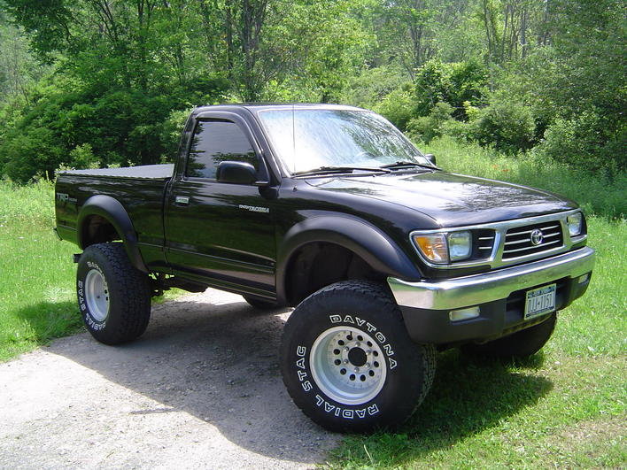

    i had a 99 4x4 with a 3 inch lift and 33x10.5 BFG AT's and they rubbed up front when turning, i had to take off the mudflaps and trim some sheet metal

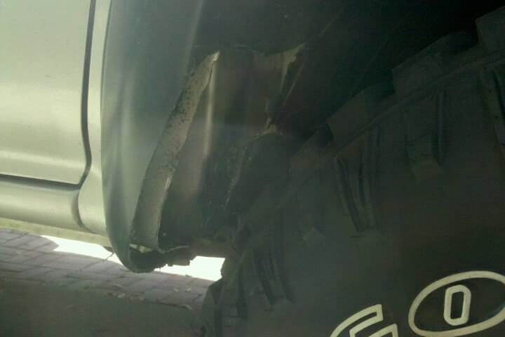

    ive got 33x12.5 on 15x10's with a 3 inch lift. they rub bad in the front without allot of trimming. they arnt bad on the road but forget any serious wheeling. looks damn cool tho:D

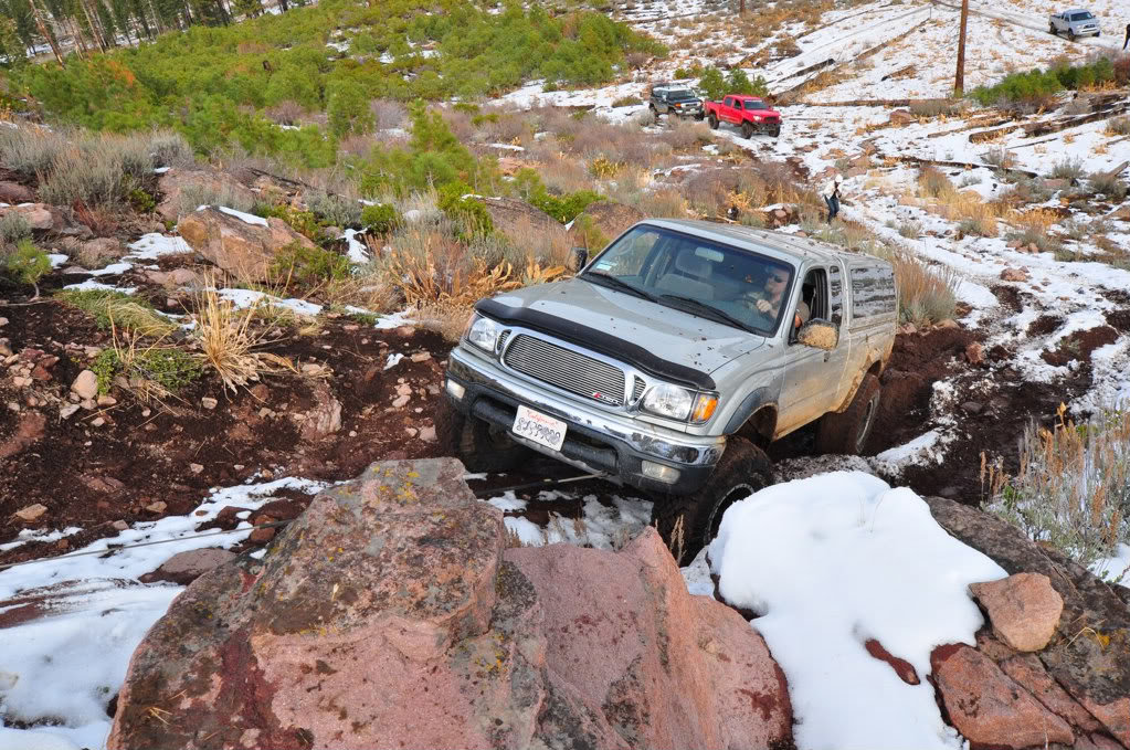

    Shit just CUT! I have 33x12.5x15's and i can wheel the shit out of my truck well as much as I can with IFS and no armor.
    I hit this trail this trail right after i put the tires on and no rubbing.
