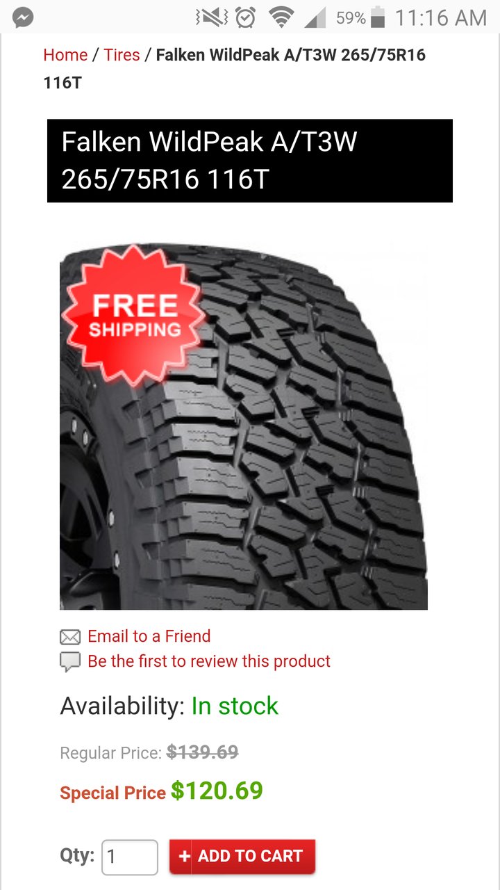

    Found this Performance Tread
    $120 a piece 265/75/16 Falken Wildpeak A/T3W.

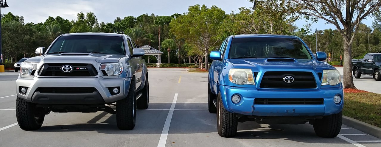

    What is that tire size? Lookin good
  6. Aug 19, 2018 at 4:36 PM
    #206
    Mully
    Mully Well-Known Member
    Feb 12, 2014
    #122907
    5,272
    CA
    12 DC 4x4 Lifted Sport
    Lifted, Kings, Locked, 295s and more.
    265x70x17 Duratracs.

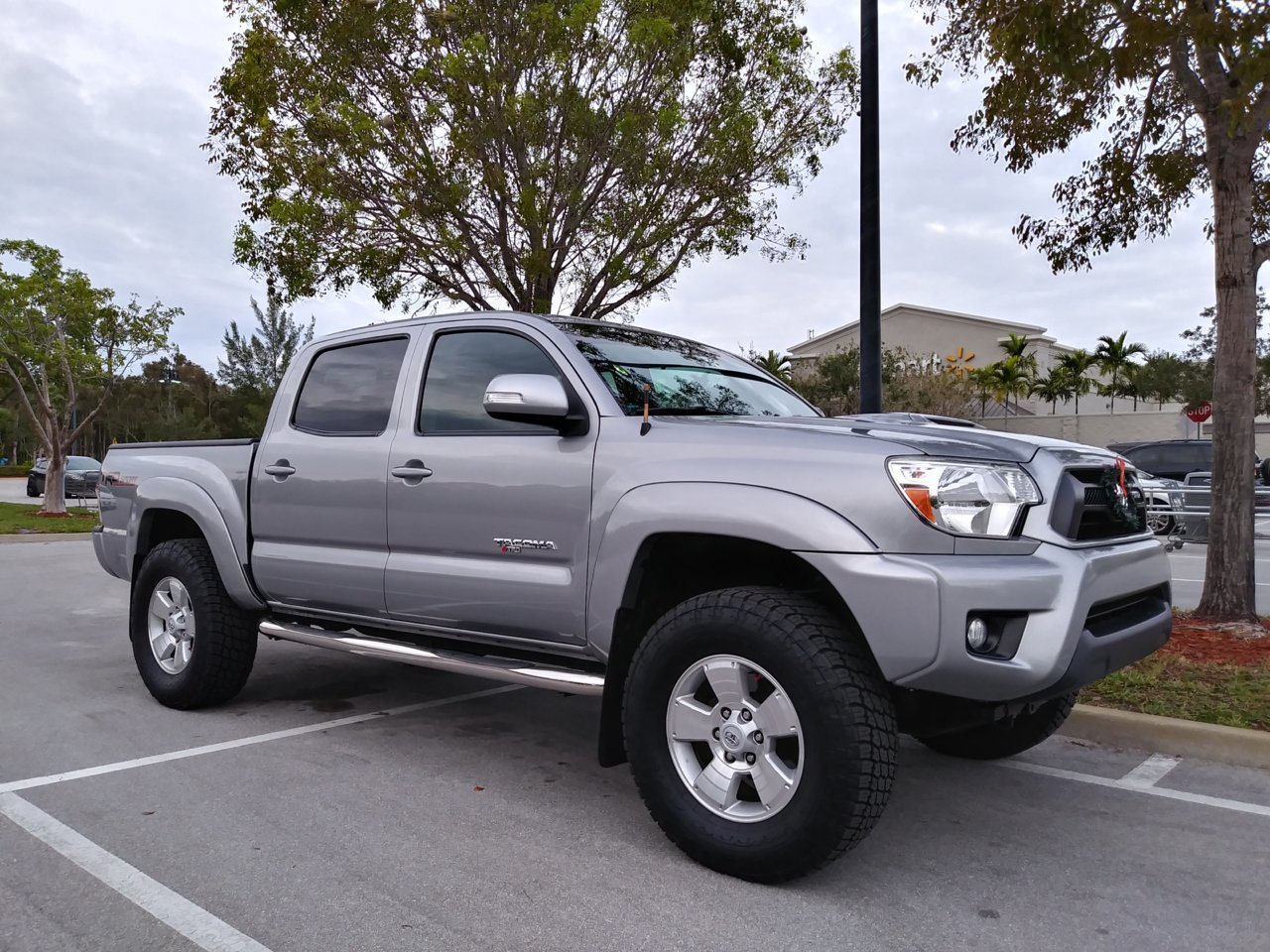

    Stock
  10. Aug 12, 2019 at 3:03 PM
    #210
    Boomerang62
    Boomerang62 Member
    Oct 26, 2016
    #200746
    21
    Jupiter Florida
    2014 Silver sky met Tacoma TRD 2wd
    Stock
    285/70/17 Nitto Grapplers g2's with 2 inch leveling kit with Monroe air shocks in rear. 1.25 spydertrax added because of UCA clearance. I left mud flaps on but removed front mini flaps.
