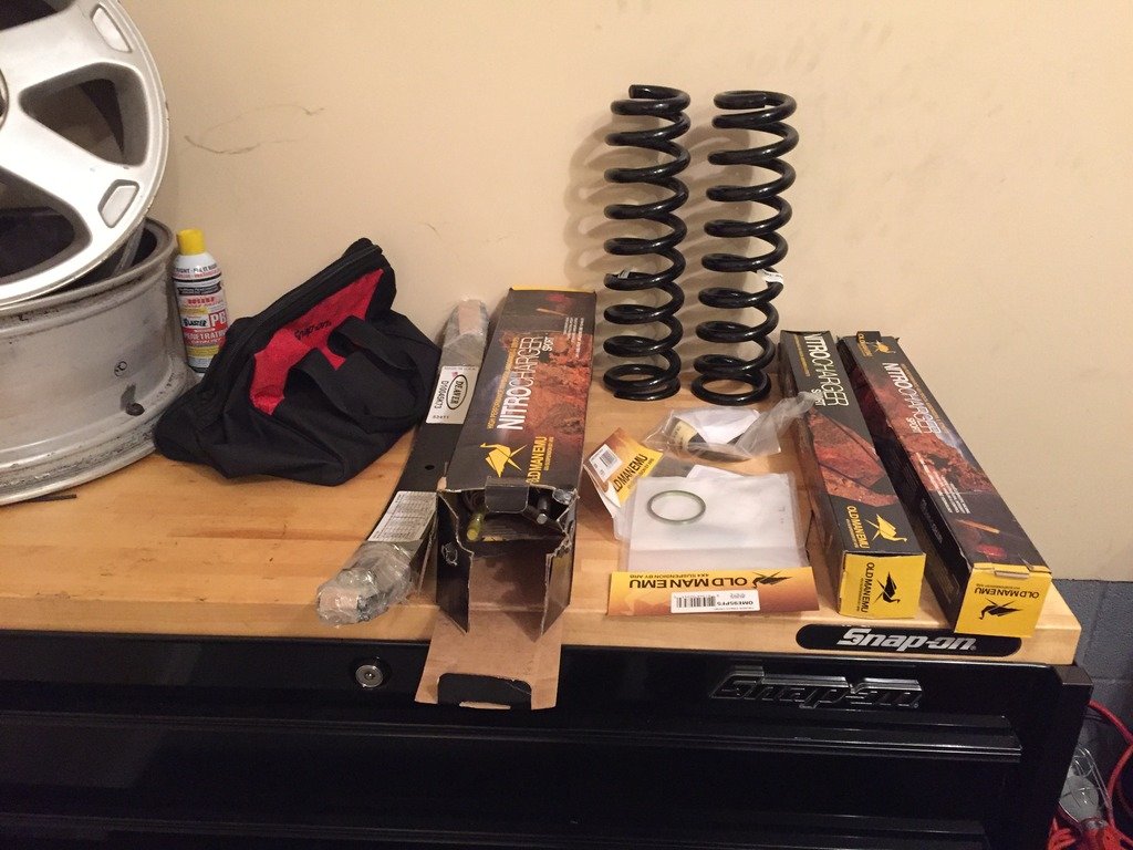

    hey guys, i have a little vibration from my needle bearings for my front axle around 40mph. there is a tsb for it so im thinking it was purely coincidental. Other that that i have no vibrations i have no axle shims, diff drop or carrier bearing drop installed. I bought the carrier bearing drop with my lift kit in case i needed it but i don't. i also have no top plate spacers, and i still have stock UCA's. I also removed my front swaybar
    I have the 885 coils and lifted my 4cyl 5speed access cab 3.25 inches exactly in the front on both sides. I put the trim packer on the driver side strut. For the rear i installed deaver AAl i got 2.25" lift out back. I have the ome nitro shocks all around. Had to take a grinder to my rear shock perch's on the axle housing to get the shocks to fit(different style on the 15's)
    7B6E673F-81BE-47EE-9068-493D9EF50AC5_zps_395edb44ba5b293445e3a870922b4e637b0f39dd.jpg
    My alighnemt is fine. i marked and put the alighnment cam bolts back exactly where they where at stock my truck has a little positive camber but its within spec.
    I can not recommend the shock's
    I was planing on getting ome coils and billy shocks, but went full ome. A lot of people are happy with them, i was told and the general opinion around here seems to be the ome coils should have the ome shocks. "Tuned for them","Valving" ect. a lot of good technical words thrown around.
    I figured ill cough up the extra $$$ for some ome shocks. The simple truth of the matter is the front shocks are not long enough. Maybe arb spent all there money engineering the "valving", and "tuning" and over engineering metal internal bump stops that they didn't have enough money to have a guy read a tape measure
    Don't waste your money on these shocks. Thats my take on it and i wish someone told me that before i bought mine. Never the less ya live and learn!
    They seem to be alright on the road (avoiding speed bumps and dodging bigger pot holes of coarse) They are bearable on gravel/logging roads as long (as you go slow) but thats it. If you like to off road on even slightly rockier stuff or like to drive on the beach (sand) faster then 20mph once in a while your going to hate how it bangs you truck around.
    I notice myself driving much more cautious since I put this lift on... seems to be the opposite of what I wanted when shopping for "offroad suspension"
    i have no issues with my rear shocks!

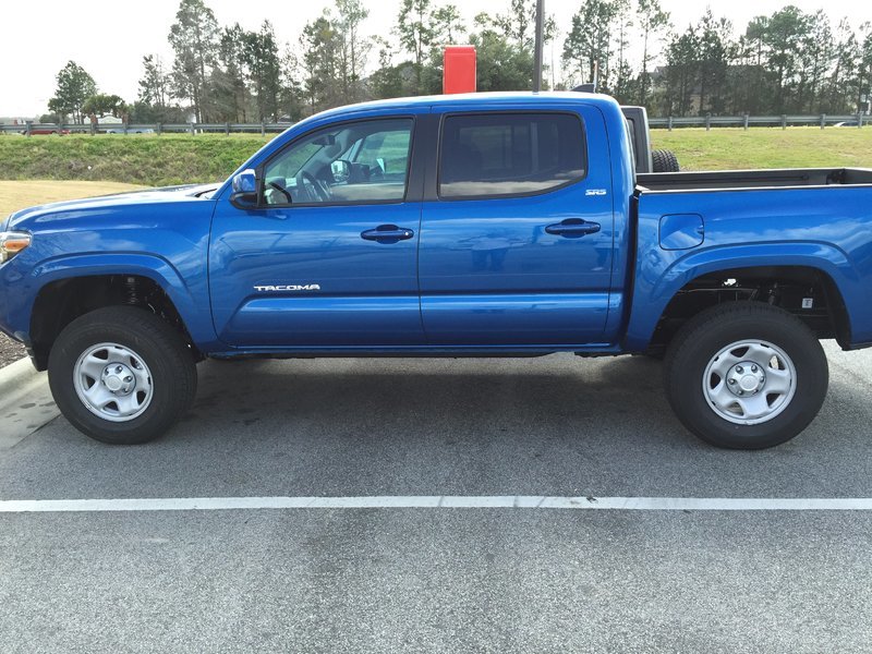

    Here's my 3rd Gen with 3" lift and stock wheels and tires! Waiting on my new wheels and tires!

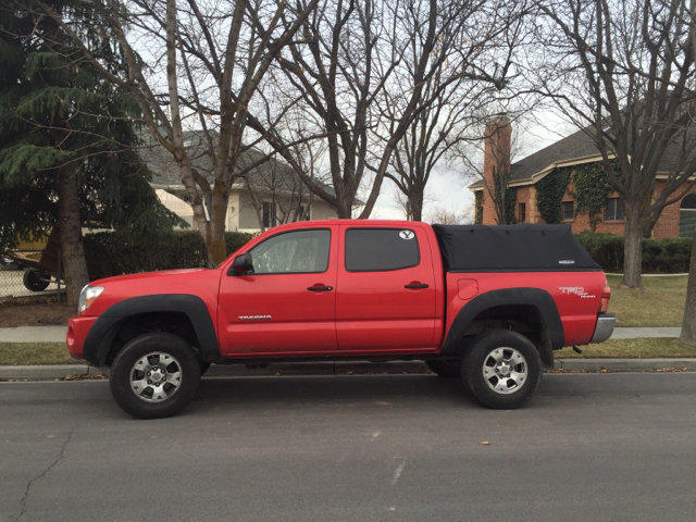

    Here's mine. Toytec AAL and spacers up front. 5100's and coilovers will replace the spacers this fall.
