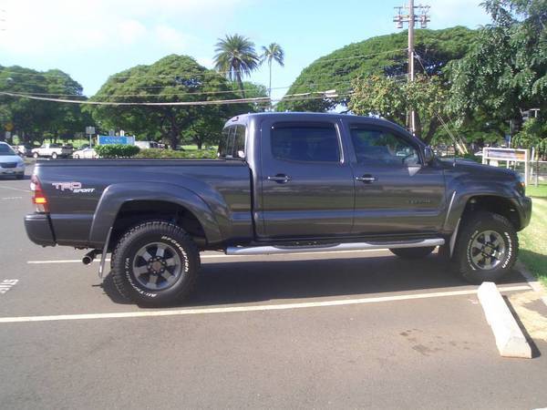

    I see a lot of lifted Tacomas on Oahu. I see a mgm tacoma sport everyday when I go to school. It parks on Beratania near the JCC...is that anyones truck on here? Its lifted with a retractable bed cover and black rims...super sick

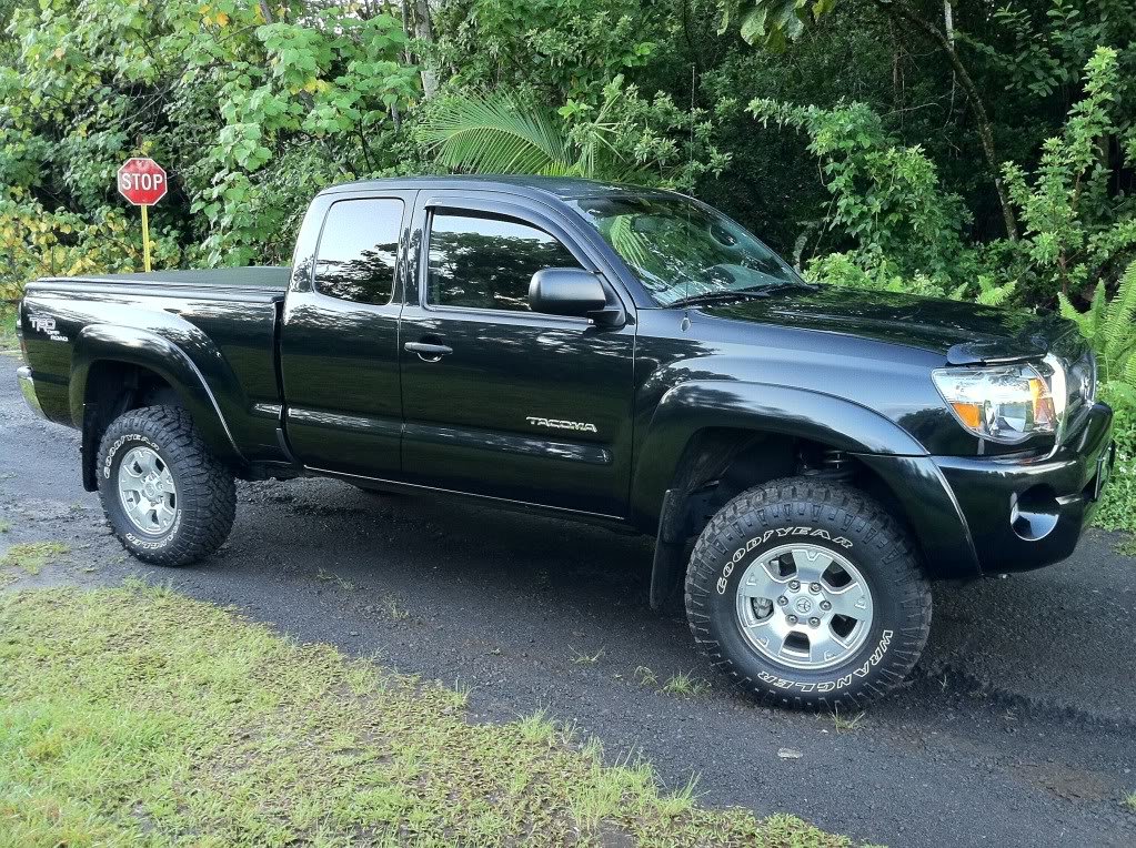

    A pic of my setup in case you are interested:

    Larry, I think that is your truck that I see everyday..do you park near the JCC?

    That's sick..I don't really wanna drop 1k+ on a lift kit. I don't plan on doing any off roading in my taco. Just wanna accommodate bigger tires and have a little more aggressive stance.

    Sorry on getting back so late. Thats not my truck. Magnetic grey is the most common colored Tacoma on this island, but yeah, go with toyteclifts. Ordered some parts from them, pretty reasonable and fast shipping.
