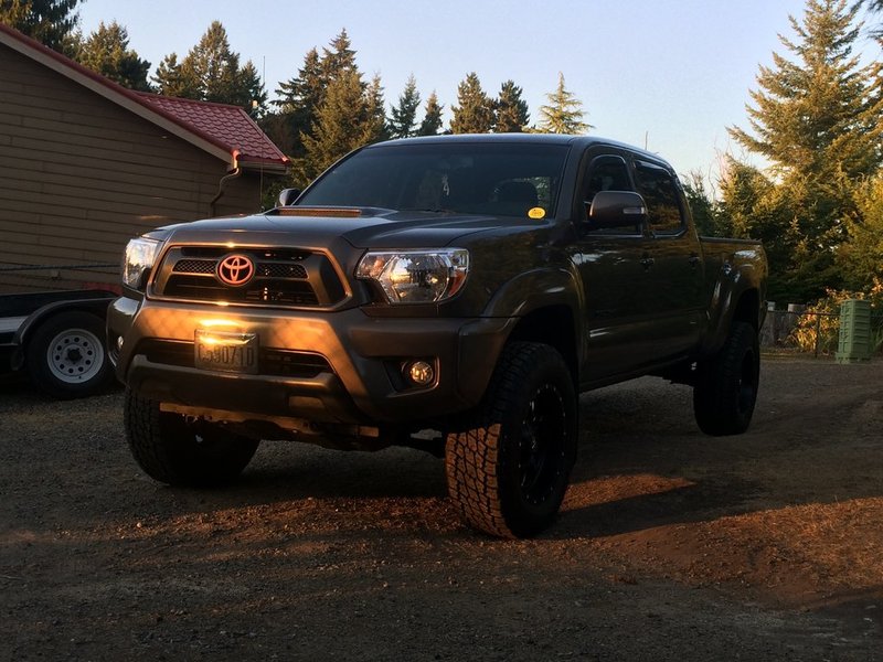

  20. Aug 19, 2015 at 8:00 PM
    #20
    Tacomagirl13
    Tacomagirl13 [OP] Active Member
    Jul 1, 2015
    #158518
    40
    Katie
    2013 TACOMA
    Here is the finished product. Thanks too everyones advise
