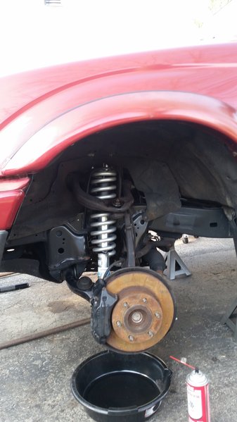

    but what "disaster"? I've had my spacer lift for 2 years now and everything has been fine aside from already needing ball joints.

    and wtf is up with your rusted rotor? lol

    Cause rotors build rust if they sit? The truck sat outside in the rain for a week. I've just heard bad things about spacer lifts, good for looks and street use, but if you wanna off road I think your asking for trouble.
