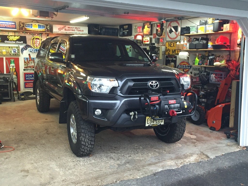

    Got tired of reading... But, have you considered 255/85/16's?
    33" tires, narrow enough to clear without trimming. Depending on the BS of your wheels. I have mine on TRD OR wheels. No rubbing, no trimming with OME 886's, 1/4"'top plate spacers, full Dakars in the rear :thumbsup:

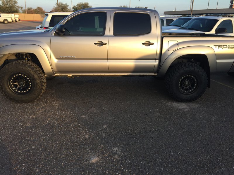

    My kit was installed two days ago, on stock wheels right now, tires and wheels should get here this afternoon. Ordered 285/75/16 nitto grapplers M/T. Don't mind trimming a little if I have to. Got a full 3" front lift so hopefully won't have to trim much.

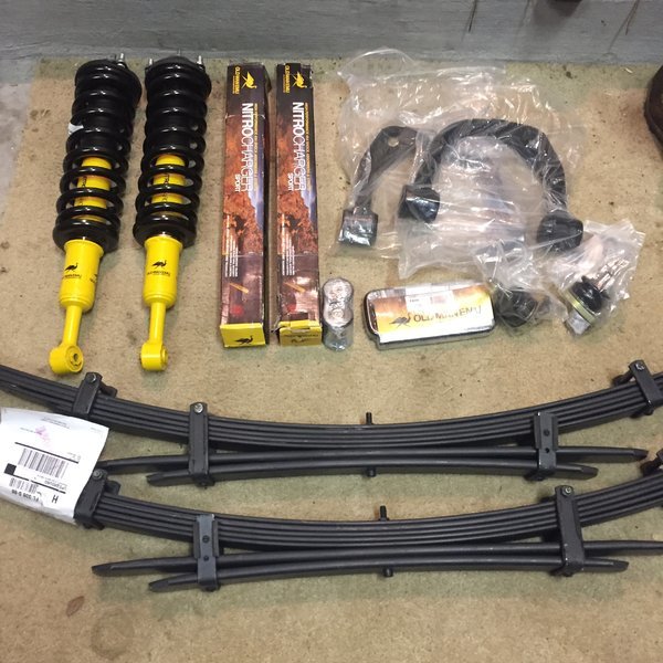

    Installed my full ome kit today... Wasn't too bad. Didn't measure before and after but I like what I got out of the lift, sits pretty level.

    Yes I'm happy with mine, had to trim a bit for front rubbing but that's all. Waiting for some rain to arrive to go mudding.
