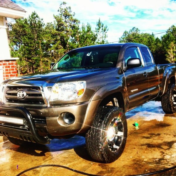

    3" lift, 18" XD spys, 33" nitto terra graps, 1.25 wheel spacers, bull bar + light bar.
    [​IMG] 3 inch toytec lift with 18'' XD spys & 285/65/r18 nitto terra grapplers did require some trimming.

    yeah they're 18x9 have a 1.25 inch wheel spacer for adapter as well
