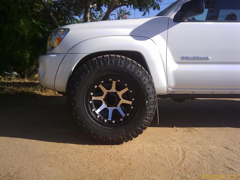

    A taller tire (i.e. more rubber/height profile) provides a larger ground patch contact area. Taller > Wide for 'most' off-road purposes (except sand).
    The bigger your wheel is the lower your height profile (think sidewall) on the tire itself will be. So, when you air down for off-road purposes you'll have more ground contact with a taller profile. Therefore, based on this argument, some will say that 16" is the best size for off-road wheels (compared to 17+).
    Ultimately it's all about what you actually intend to use all this lift and tires for.
    You can do a 33" tire with a 3" lift.
    255/85/16 = 33" (Tall skinny)
    285/75/16 = 33" (Wide - Requires Cab Mount Chop)
    Exaggerated examples:
    Big Wheel w/ Small Tire
    Smaller Wheel w/ Big Tire
