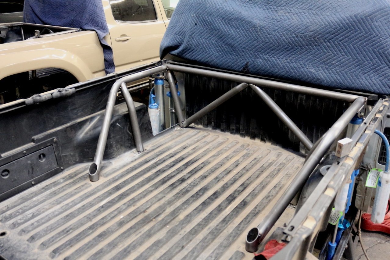

    Question for you. Is your bed cage completely supported on your bed bolts only?
    I know guys run a bed cage setup only supported by bed bolts with their leaf kits and I think they get away with it (ive never ran this setup). I would be pretty nervous about running a linked setup with the coil overs mounted off just the bed cage bolts. That is a lot of force being sent through that bed cage.
    I also believe that you will need a vertical tube from the upper corner of your coil over mounts directly down to the frame to resist deflection there. This would help greatly with the bolt problem as well.
    Either way looks like a cool project, and keep posting updates and keep an eye on those bed bolts and watch your bed cage for cracks.

    Dirt Designs has a similarly minimal cage for their link kit, and a couple guys have been running theirs with no issues (that I know of)

    Is the Dirt Design cage available by itself? As far as I know, I can only find DMZ and Camburg that offer ready to bolt on bed cages that could work for a 3 link kit

    I'd be curious about the bed bolts as well, assuming they are a high strength bolt I would imagine they would be perfectly fine. I wonder if Toyota has ever put out the specs for those bolts or if anyone had done any strength testing on them so see how strong they are.
    Next issue would be the actual "mounts" for the nuts that tie into the frame, but that's probably just a matter of adding some gussets or plates.

    If worst came to worst you could just drill out or cut out the bolt mounts and replace them with beefier 5/8 grade 8 bolts and weld thick plates with nuts on them. I'm getting rid of the bolt setup on my first gen and going to something similar.

    Dirt Designs bed cage sandwiches the bed floor at each mounting point (including the bed bolt) with a new thick frame mount... Notice the vertical tie ins too
    https://www.tacomaworld.com/threads/bedcage-thread.263850/page-9#post-17169781
    This isn't a knock against you, I just don't want to see you lose a bed bolt driving down the freeway.

    Here’s what he posted on the cage mounts. While I personally don’t think it’s “optimal” for coil over mount, I also don’t see any real issues either. I’d be okay with it. There’s always a “better/stronger” way, always. I think this is adequate. Maybe if it was a race build, running secondary bypasses, and really running the truck hard, yeah, maybe beef it up. I think it’s fine for what it is. The Camburg cage bolts to the frame through the bed, the DMZ does both. My idea was to use tube spacers that go through the large bolt holes in the bed so when you tighten the cage down, you’re not tightening the cage down against the composite bed and frame, it’s metal to metal. I think this set up is fine, and after working on aircraft for years, I don’t think people realize how strong bolts actually are when used right to hold subframes and structures together. And like said above, you could always drill the factory welded nuts out and use larger hardware. Just one of the bolts will hold up the entire truck by itself, I’m sure it’s fine. Only thing I would watch for is shearing movement between the cage/bed/frame. Might cause wear or noises but I bet it’s fine.

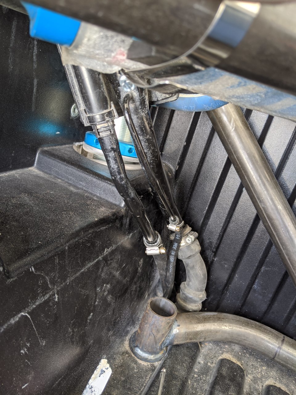

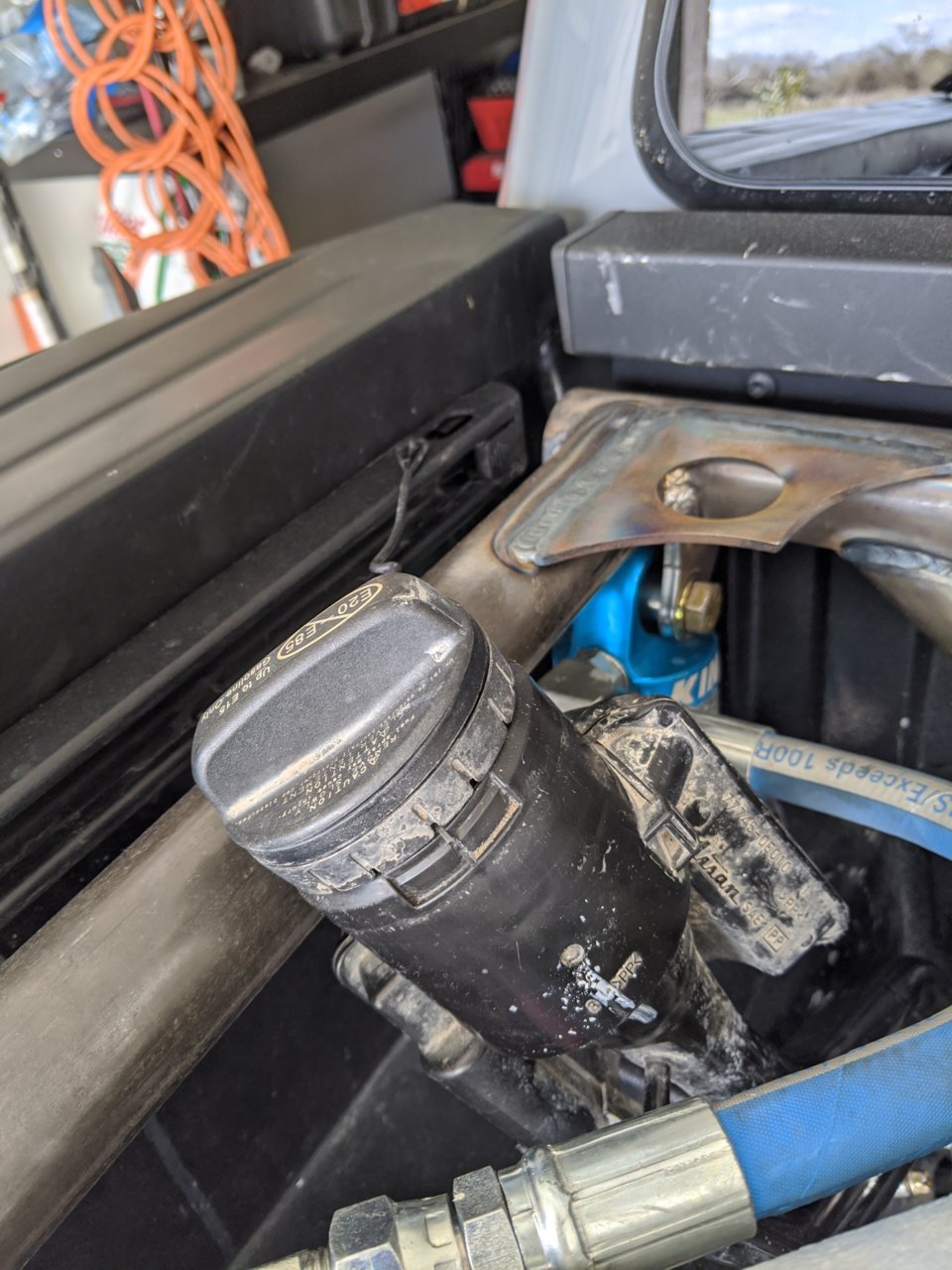

    @taco_sos how does the driver side coilover fit with the fuel filler neck?

    Hey guys, I'm responding to the bedcage posts I've read here. Thank you for the input and I appreciate it.
    Before starting this project I did a lot of research. Most of the answers to my questions came from reputable builders in our community. As far as the bed cage, I've spoken with Giant Motorsports about their bolt in cage that utilizes factory bed bolts. He's claiming he runs these bed cages and has had no issues whatsoever. Seems weak, I know. But I'm taking Giants word for it. My cage actually hits 6 different spots to help distribute the force. Most of the force comes from bottoming out, which the bumps would take. Those are mounted to the frame, exerting some force to the frame itself. I will keep an eye on it. Nothing will be painted until after the shakedown. Makes it easier to spot any cracks that way.

    The filler neck is going to be rerouted to the bed and I'll use the cage for mounting it permanently. See pics
