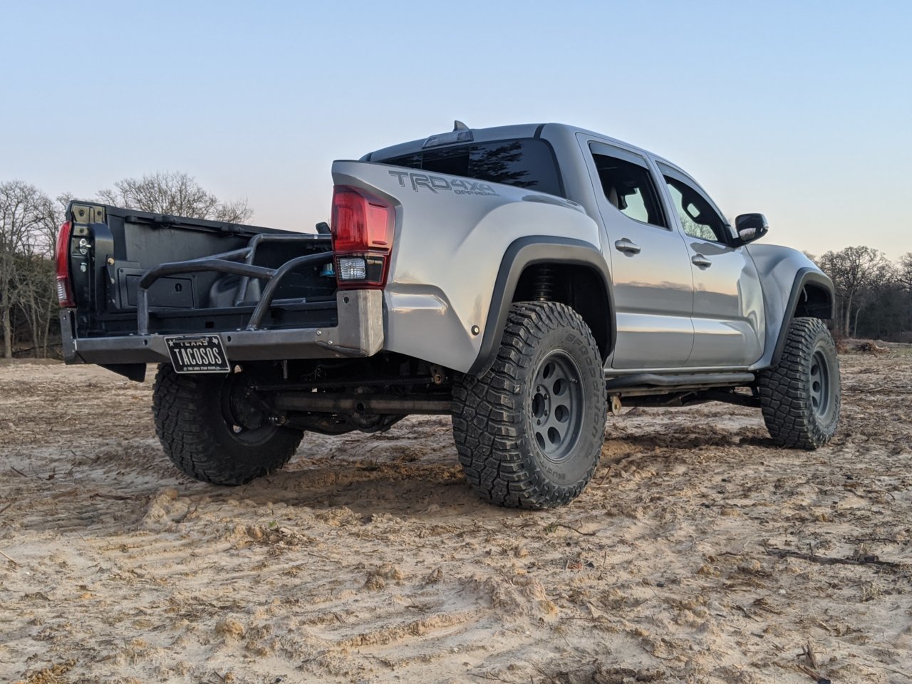

    Q: Is the bedcage strong when tied in to factory bed bolt?
    A: YesIMG_20200301_130921.jpg

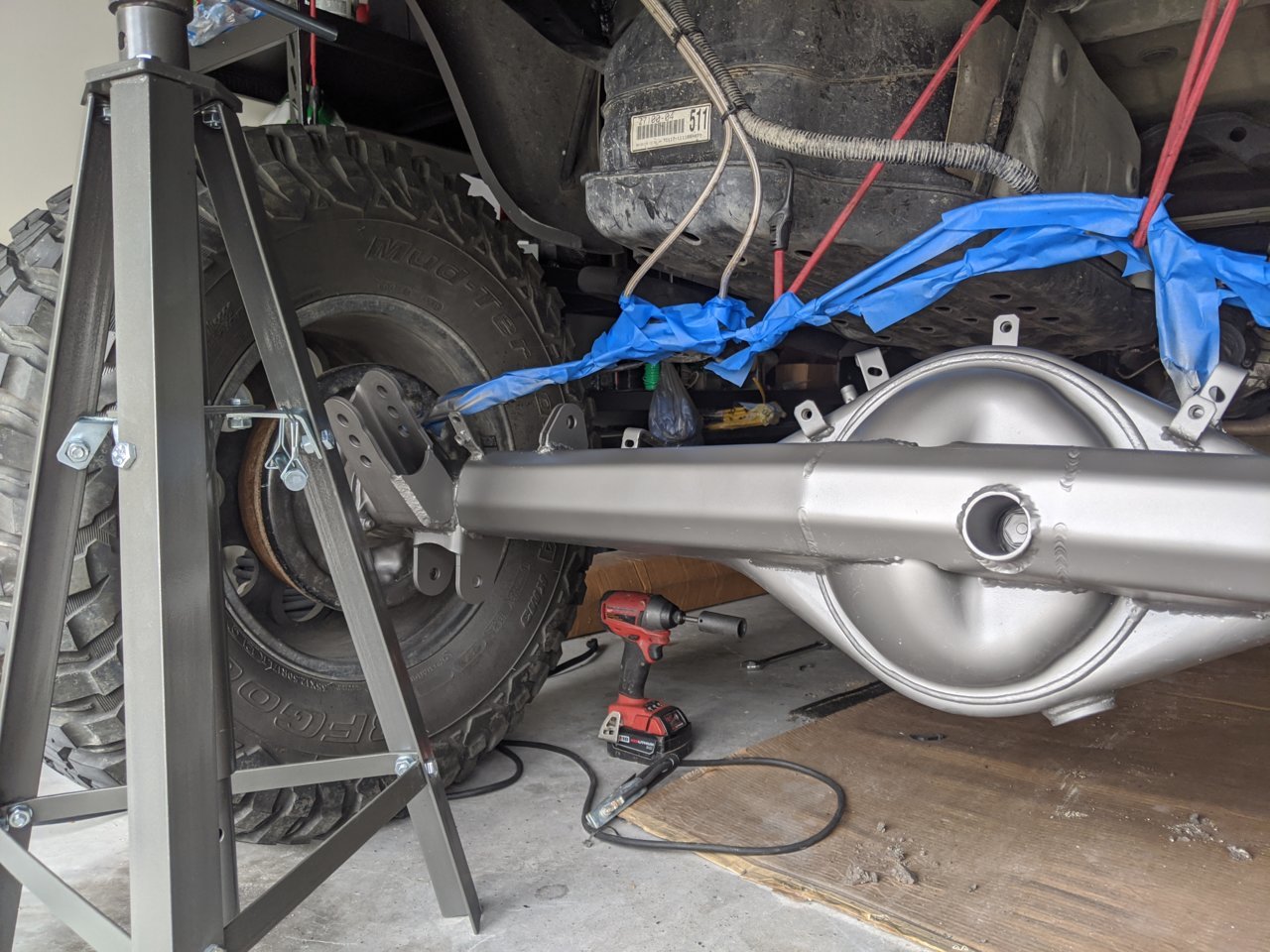

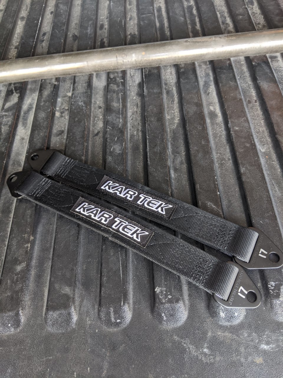

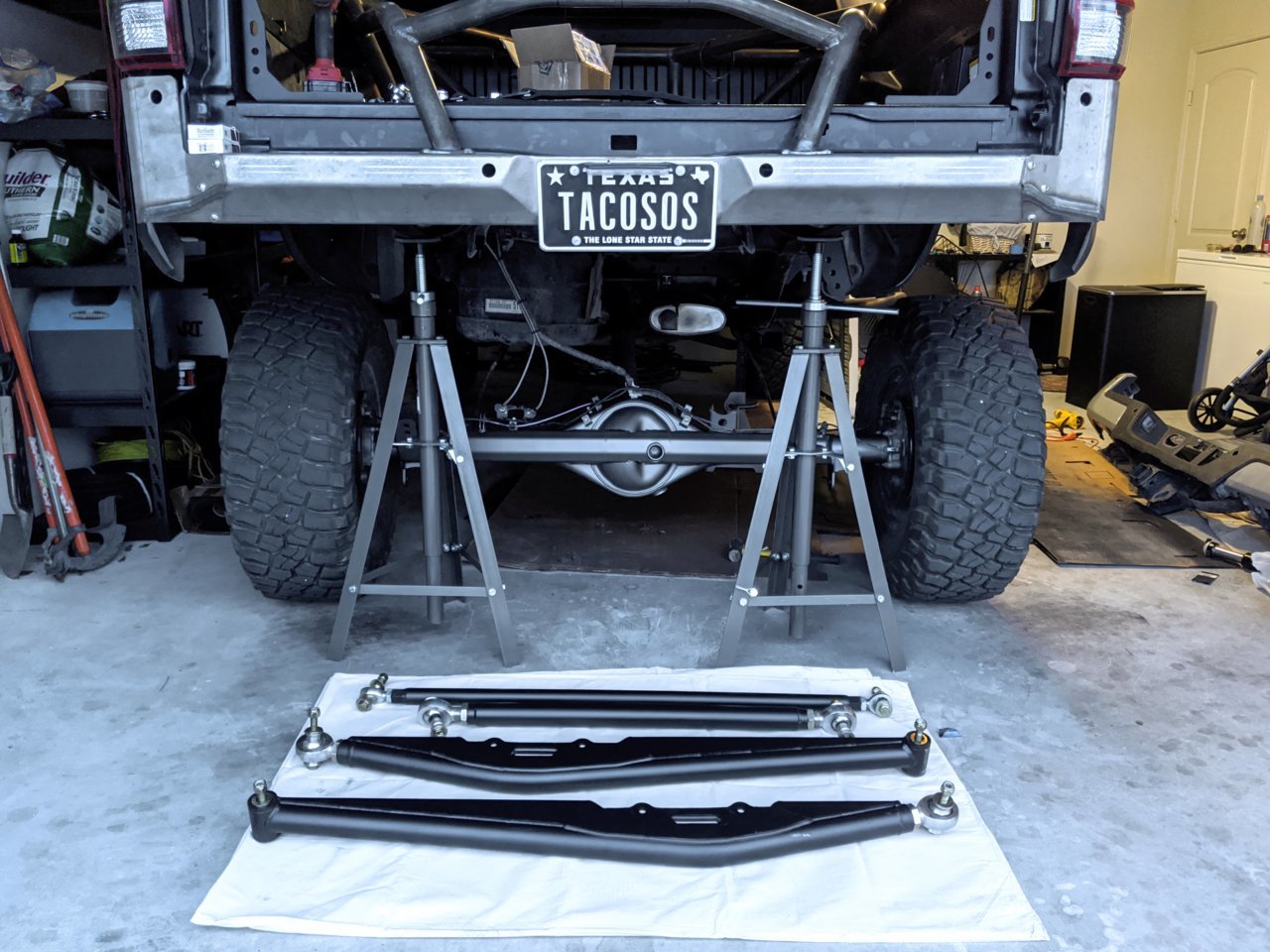

    Finally got the axle tabbed for straps. I ended up using a 17" strap and tabs from Kartek. IMG_20200305_172831.jpg
    I got mostly everything painted. I used Steel-it in gray for the axle and the link components in black. Hopefully get the cage and bumper painted this week. Painting those black as well. IMG_20200308_144041.jpg IMG_20200308_193134.jpg

    @taco_sos One other question I've been wondering - mow much longer are your brake lines in the rear?
    Would +4" over stock be sufficient for links?

    I doubt it. I have the 4” extended lines from Wheelers and I have them tight at full droop. And I can guarantee he’s got more droop than my 13” travel leaf set up...

    Good to know, as those were the ones I was looking at. They also sell ones that are 24" long -- not sure where that relates to oem though. Marlin crawler sells some that are 26" long.
    A thread here:
    https://www.tacomaworld.com/threads/brake-line-length.340814/
    Says that oem is 17.5" long, but also on Headstrong site, their +4" lines say that the oem length is 20".
    https://www.headstrongoffroad.com/store/p127/24"_SS_Extended_Length_Rear_Brake_Lines_(PAIR)_-_05__Tacoma.html
    I could just go out and measure my truck but :rofl:
    EDIT: My oem lines are 19" from hardline bracket face to bracket face. Probably ~20" including that part thats behind the bracket.

    I used brake lines from DMZ. I think he said they're 24 or 26 long. Theyre almost extended at droop.

    Lengthening a tacoma's already long wheel base isn't that big of a deal.
    Handling can be built into the link geometry or add a sway bar if it's too soft.

    It is really close on a short bed trying to stuff a CO and bypass in but it can be done.
    Custom 4 link a buddy is doing:
    I can't recall how much they moved the axle back but it wasn't much and won't matter a whole lot on crawling trails.
