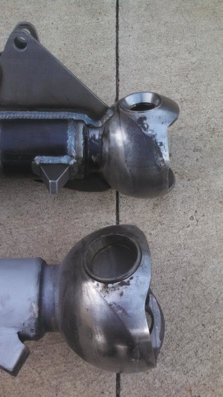

    Don't built a mini. If you still want to keep toyota, go 80 series outer with HF. And get the wms you really want. Don't built a custom axle then add wheel spacer, seen a few folks do that... lol

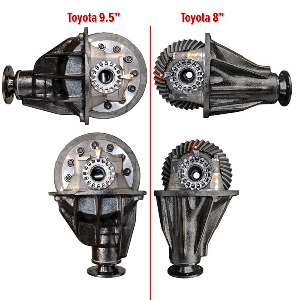

    If you're building a custom axle and still want to keep toyota outers, opt for the land cruiser fj80 knuckle ball and ruffstuff hellfire knuckle. Way more massive compared to the mini that everyone sells on their axle. Will cost more, but well worth it IMO. And go with the fj80 9.5 centered instead of the 8"

    I would go 60 outers, screw toyota stuff for a custom axle. The turning radius SUCKS compared to an open knuckle.

    I have to agree with slander on this. Go 60 or 44 outers for better turning radius. I have no real reason to upgrade my front axle but I’m after better turning ability and instead of cutting my ends off I’m just starting over. Toyota axles suck at turning.

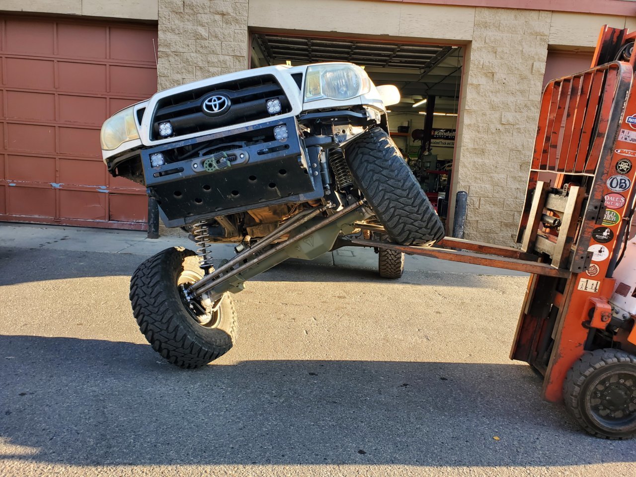

    3LINK with 14" coilovers
