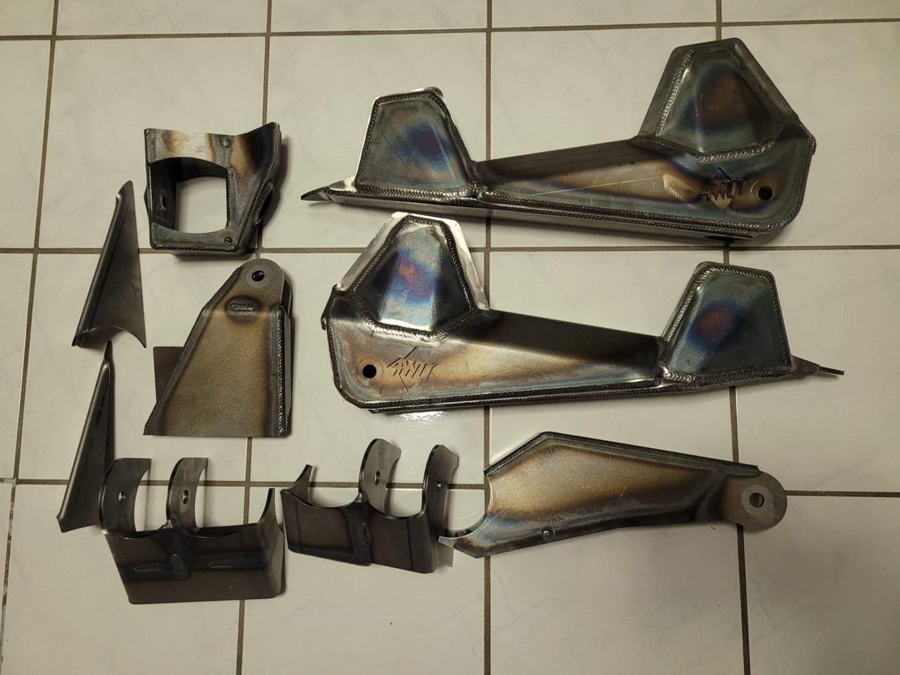

  10. Dec 6, 2020 at 12:25 PM
    #70
    4Wheel Underground
    4Wheel Underground Well-Known Member
    Aug 26, 2016
    #195603
    50
