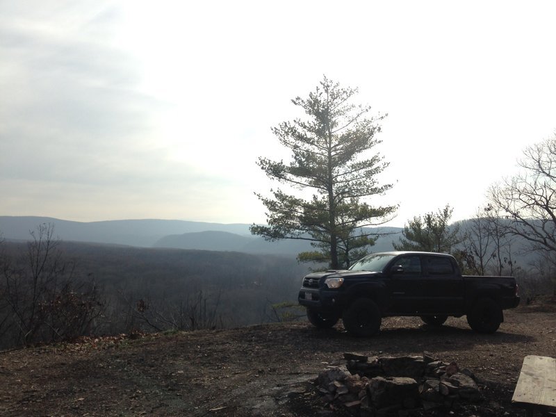

    So I searched quite a few threads and builds, haven't found exactly what I am looking for. Forgive me please if the information exists elsewhere on this site. I haven't been active on truck forums since toyota120.com when I had an '03 4Runner.
    I have a 2012 DoubleCab truck with a cheap lift and some very "high school" rims. The rims are 10.5 width I believe. I fit 285/75/17 right now.
    I have acquired some 17" tall 7" wide 4Runner rims. I would like to run these on my truck.
    I have on pre-order the AllPro Off-road "Lola" kit.
    My question is... What are the largest tires I can run with this set up? I do not want to run spacers, I would rather purchase wider wheels or something with a more pronounced back spacing.
    I am considering the bfg 34x10.5x17. These have the potential to be slightly too tall and I am not open to doing a CMC.
    Thank you for any advice you can give. It is much appreciated, I have been going crazY trying to figure this out!
