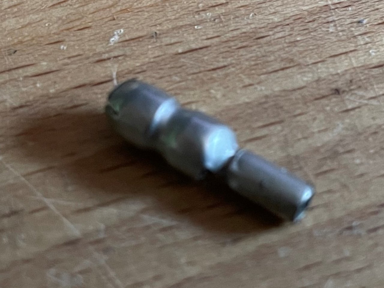

    The positive connector should be cut off and new wire slid through the factory water proof rubber boot. The supplied positive male connector is too small anyway to make a good contact with the factory female connector. Crimp and solder a proper 18-gauge male connector on the 18-gauge wire.
