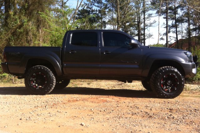

    Figure I'll join the MGM fest. Not the best shot, but Billies @ 2.5", stock springs and 1.5" progressive AAL. Gonna ditch the Bilsteins and get some Icon's and Alcan's pretty soon

    Dude thats a sweet F-ing truck!

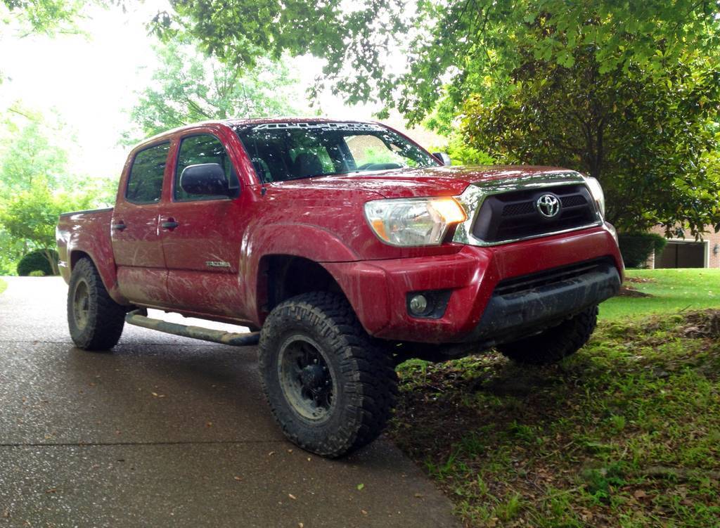

    In Brentwood, TN. 3" Lift with 285 Nitto Trail Grappler MT's

    Thanks man. It's a work in progress.
