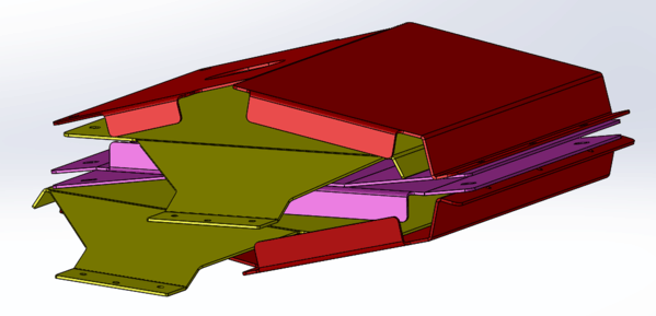

    Bump with a skid sammich.
    I can double up shipments on skids and ship cheaper through Fastenal. Gather your buddies.

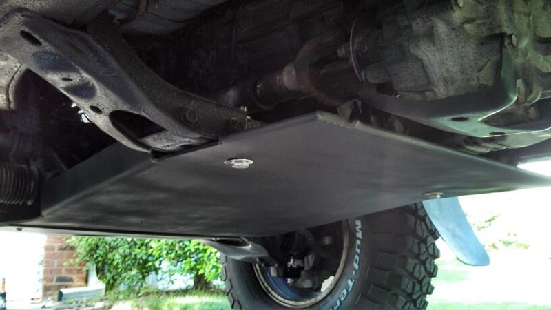

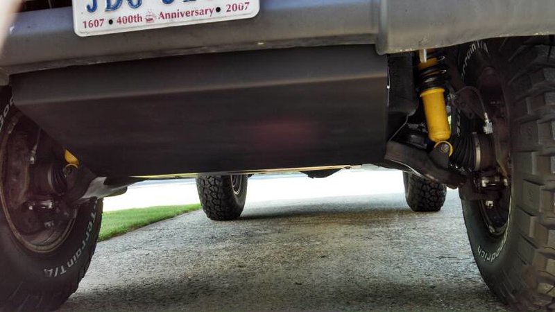

    ...skid looks a little flimsy. How about a shot of the skid with some weight on it. :notsure::notsure::notsure:

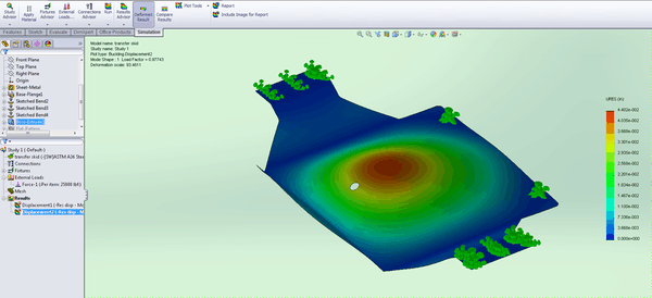

    On my computer software I put 25000 lbs on the transfer case skid and get less than 5/16" of deflection. It's not the same as dropping your 4000 lb truck on a sharp rock like you jumped it and hit the rock before anything else, but I can't duplicate that.

    At 50lbs each these are far from flimsy. I have a set on my truck..,...

    I was talking about the transfer case skid and that was all. T-G seems to think that 3/8ths steel is a little more appropriate than 3/16ths and have been doing it for a while longer than this engineering student has.
    Put a jack under it.
    When I went out to Moab I had never come close to touching the factory T-case skid, when I ran Top of the World, underrated trail, I managed to hit the factory skid and mash it flat, and that was the only part of the truck that touched. I don't know when it happened on TOTW, but it definitely didn't happen on any other trail that I was on out there. Shit happens quickly when you are wheeling, make sure that the products can do a minimum amount of real world protection before you are selling something that "looks" like it will hold up.

    I don't know what this proves for you, "putting a jack under it", but I don't have a transfer skid in my possession at the moment to even try it on. Anyhow, here's a simulation with the correct steel and about 97% accuracy to the real world material qualities and fixed in the same locations as on the truck. 25,000 lbs of force on a 1" diameter point in the center of the skid left to right, and near the rear where there isn't any mounting points. This would be comparable to jacking here, no?
    Total deflection of 0.044" at the maximum point.
    Trail gear probably uses 3/8" because Chinese steel is trash. Budbuilt, Skid Row, Metal Miller, and others seem to think 3/16" is a good choice for skid plates. I can cut one in 3/8" though if someone wants 3 times the weight.
    Please continue to bash the product. It doesn't bother me. This is what I offer and I stand behind it.

    How big are the self tappers that hold it?
    My Budbuilt is 3/16" (IFS) but it isn't stretching across the whole frame like the T-case skid that you designed does, I think that is the difference. No reason to get your undies in a bunch, just wanted to see what it looked like in real life, not virtual reality.

    The self tapping screws are 3/8" diameter. 3 per side. 1/2" bolts mount it up front. I offer angle iron reinforcement for the people that would like the extra strength piece of mind across the span. It's stated in the original post.
