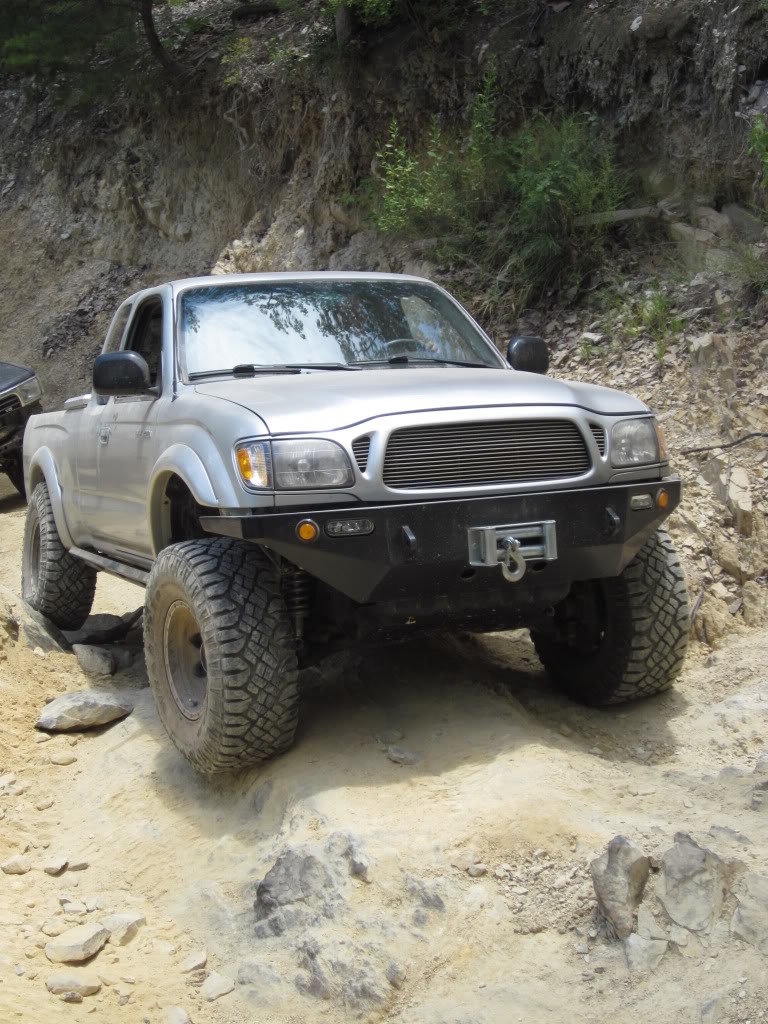

    Toytec Ultimate lift, dakar leaf springs. i did have the front adjusted up a little more after this picture.[​IMG]
