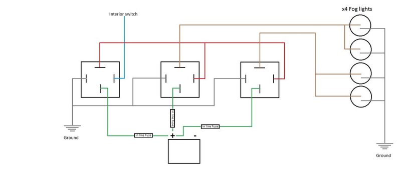

    So the previous owner of my Taco put on an Nfab bar and added four lights to it as seen below...
    They are horrible lights that arent even as bright as my headlights, but the point of this post is to try to understand why he used THREE relays for the lights...
    The first relay is controlled by the interior switch, and the other two relays each handle two of the lights, and both have their own wore to the battery with an in line fuse...
    Am I not thinking correctly, or is this the most convoluted, stupid way to wire these lights in?!?!

    63,971
    Murph

    Are you saying they are switched off the ground then?

    I'll have to get a picture, or draw up a wiring diagram tonorrow in the light. There are 2 relays wired correctly, but the wire that should be coming from the switch on both relays are spliced together and run to another relay that then goes to the switch

    I think I'm understanding that but a diagram would make it a bit clearer to understand.

    I'll draw one up tomorrkw when I have some light to work with, but I'm pretty sure I only need a single relay right?

    Could he of been using multiple relays over thinking the amperage draw rating of the relay?

    Im not asking for someone here to explain why he did it, just trying to see if there would be any reason at all to run more than a single relay.

    If you want all four lights to come on with a switch, you can use a single relay (depending on the combined amperage draw of all four lamps). I have the same light bar and two set of lights, one switched inside the cab (wired through 1 relay) and the other set switched by the highbeams (wired through a second relay)

    Currently, all four come on with one switch, he just ran two relays and spliced all the wires together for some reason. It's hard to explain, wiring diagram tomorrow will help

    It sounds like he used a single relay to trip the other 2 which splits load you are right would be way overkill and pointless. The only way you may need 2 relays with 4 lights is how much power each bulb is drawing which can not be told by just brightness compared to headlights.

    Alright guys, I spend some free time at work drawing up the wiring to the best of my ability....
