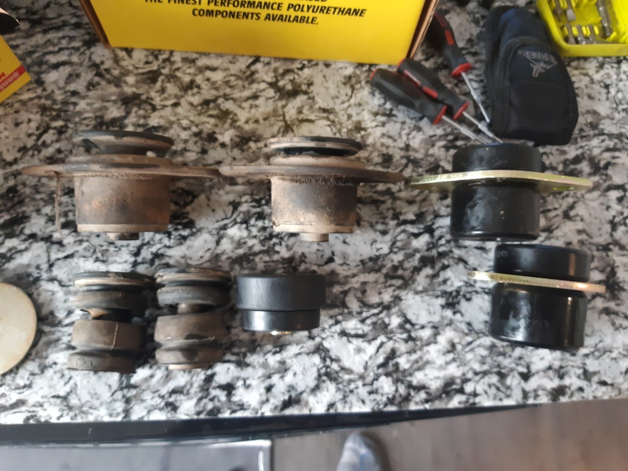

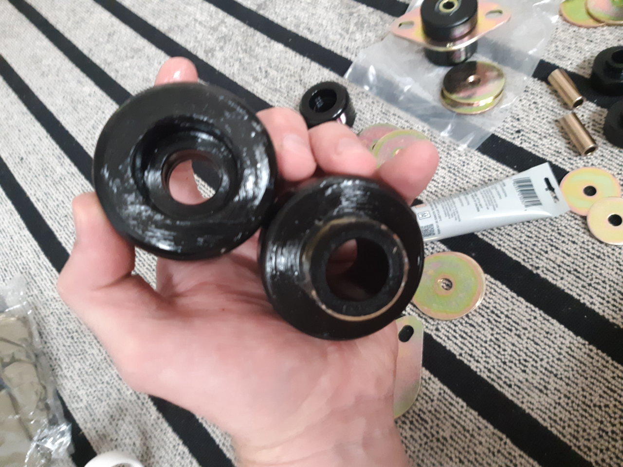

    Ok so next up is the body lift, which I started doing and then realized the body mounts needed love so i replaced those too.
    Followed this write up on body mounts so I wont be detailing the whole install:
    https://www.tacomaworld.com/threads...stall-now-with-pictures.432885/#post-12488510

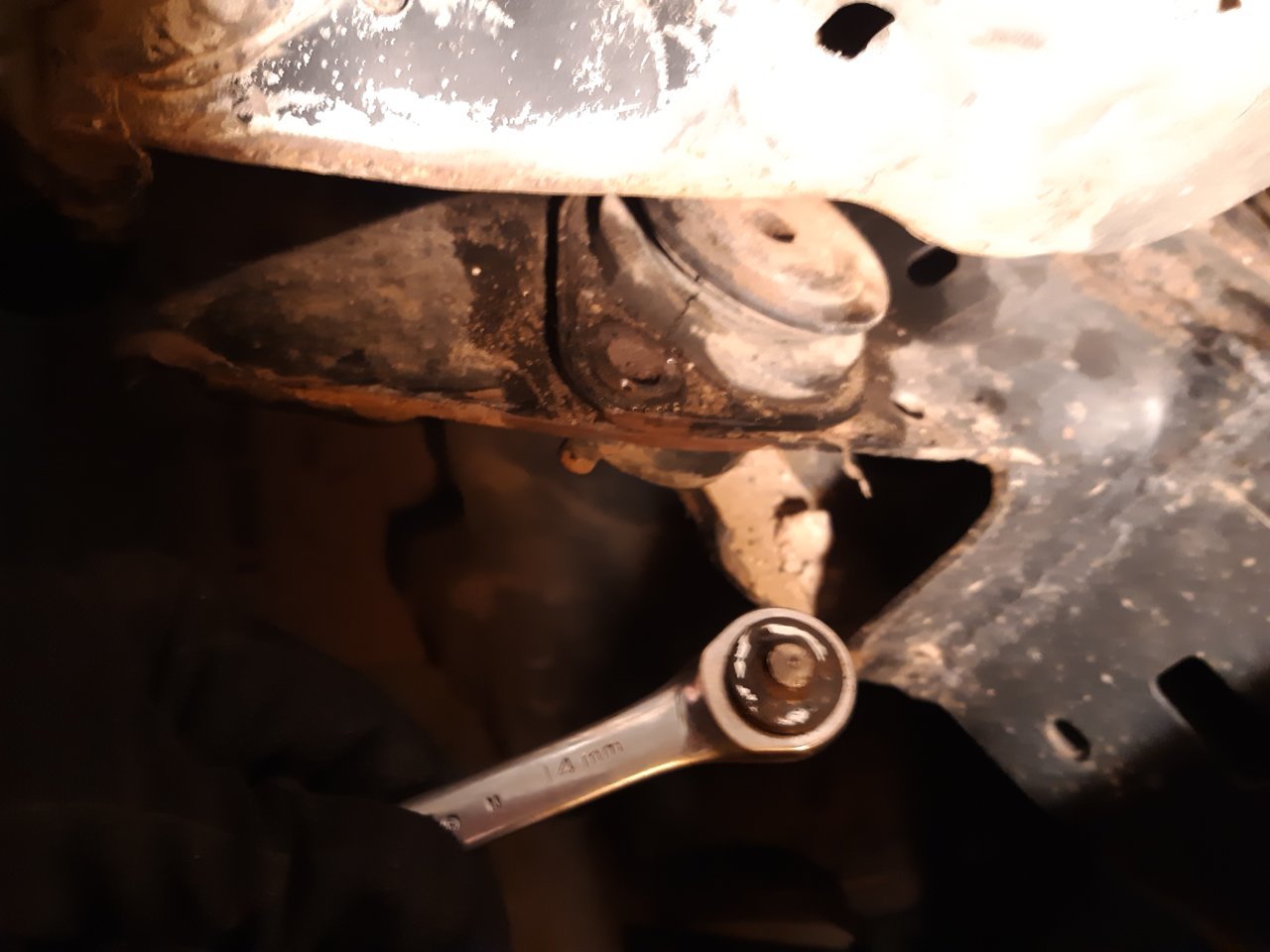

    Honestly this was one of the biggest bitches of the project so far. Not because a body lift is difficult to do...procedurally it's pretty simple and straight forward. It was a bitch because rust and seized bolts.
    On both the body and the bed, there was one bolt that decided to be a little asshole. It took multiple cycles of heat, PB plaster, and air hammer, impact and the f-word to convince them to let go. I also broke a bolt holding a body mount bushing in on the frame so I opted to replace all of them as well.
    So my pro-tip here is to PB blaster the shit out of the bolts a few days ahead of time, and be ready to replace bolts. With the body lift, the bolts get replaced with longer ones, but you re-use some for the bed. I didnt replace my bed bolts because I wanted to get shit back together, but I will when I pull the bed for my new shock mounts later this year.
    This little SOB was seized up in the sleeve. I eventually got the bushing to break loose, but then the sleeve would just spin in the rubber bushing. It took several days of blow torch and PB blaster to release from the sleeve.

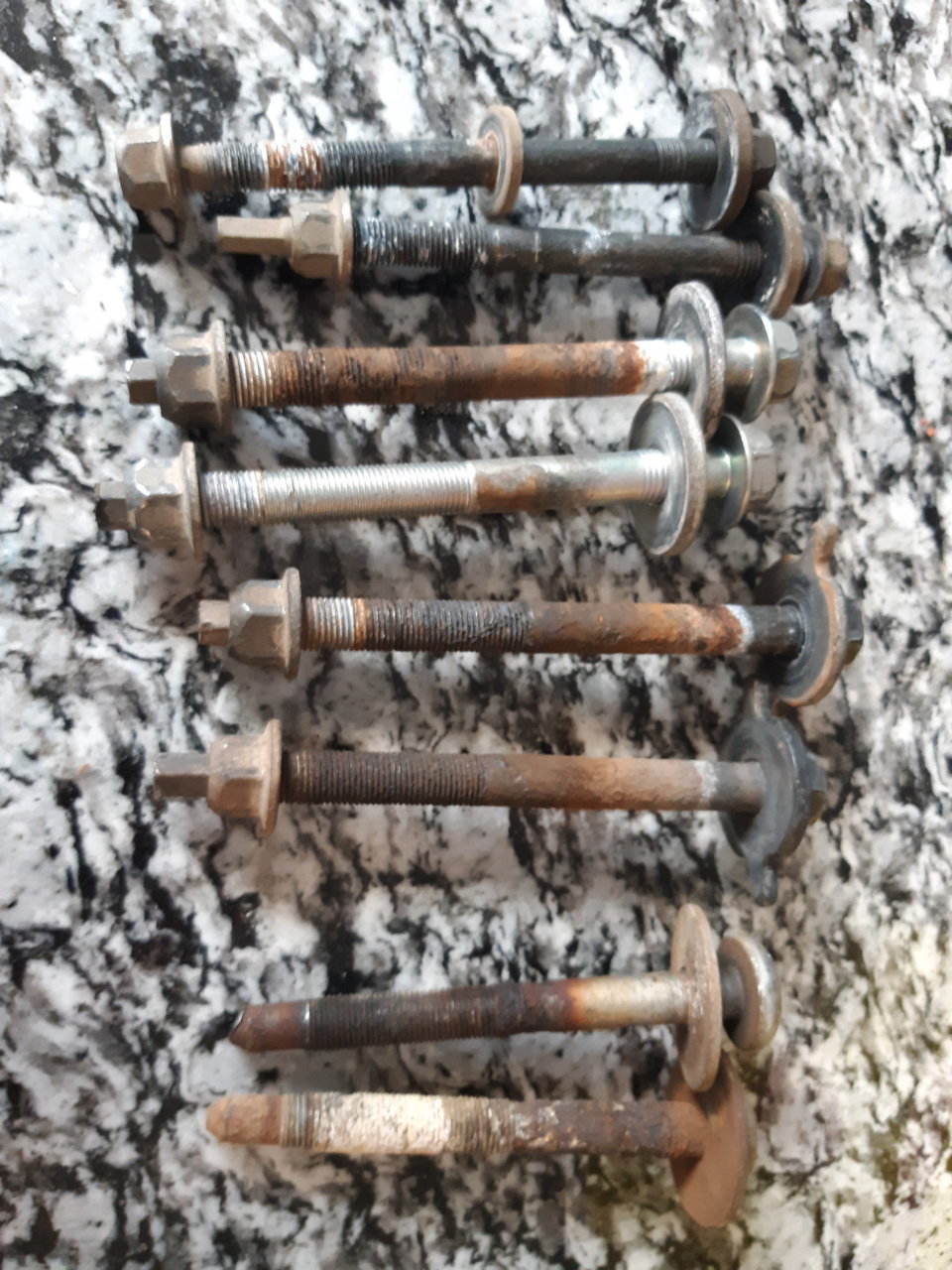

    Snapped the head off this guy and decided to replace all 8.
    Rusted bolts!

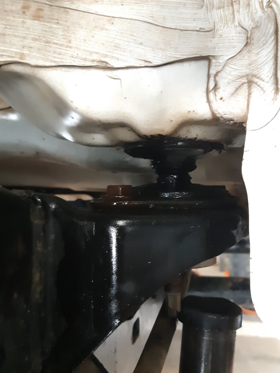

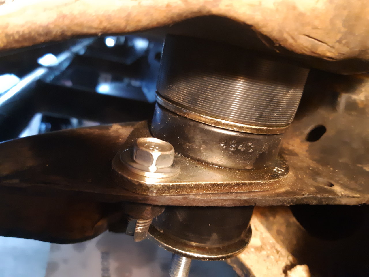

    I lubed every surface of the body mounts and lift before install.
    Old vs new

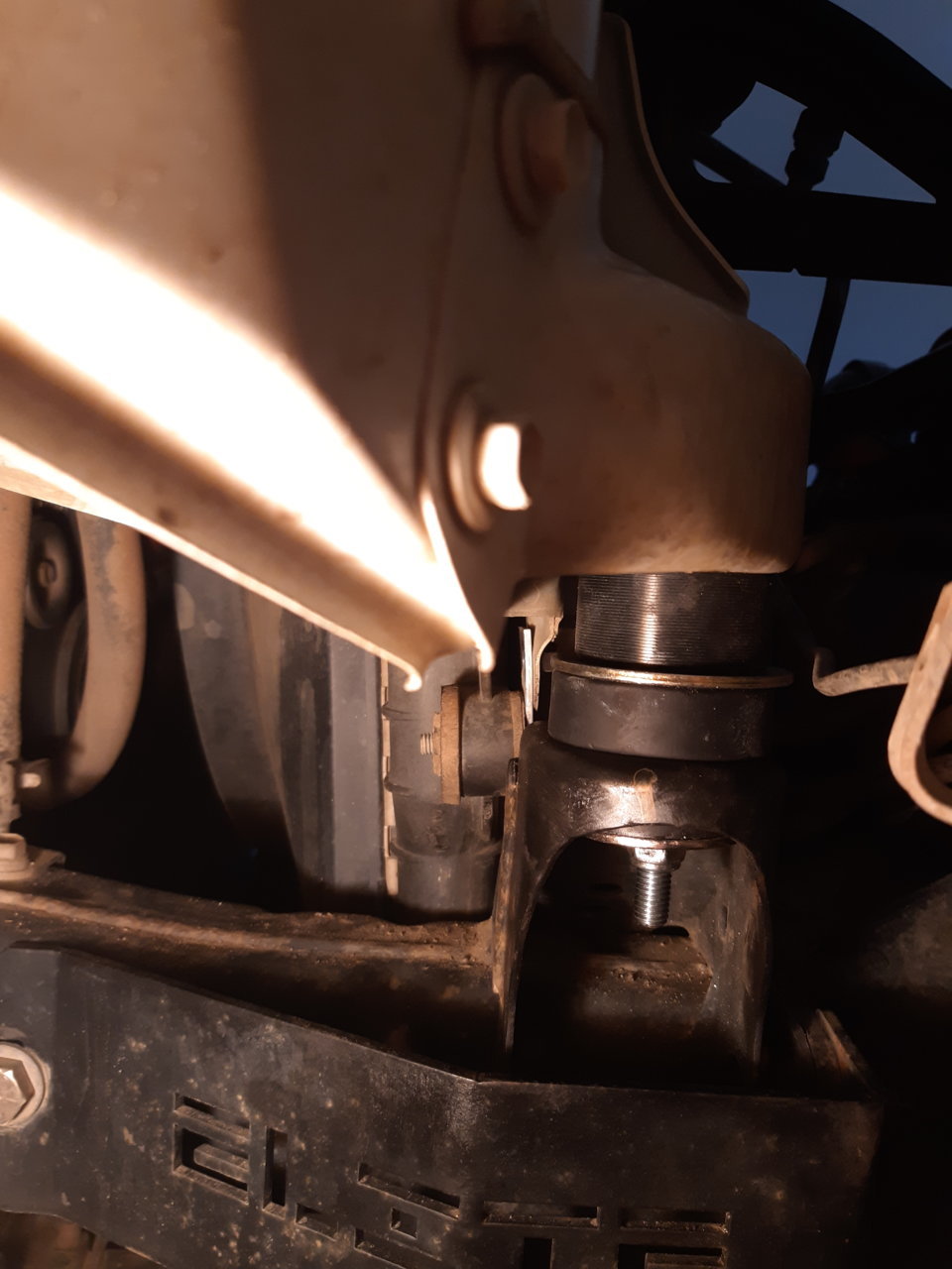

    Final:
    Another pro-tip...the pucks for the front of the cab by the radiator have smaller holes for the smaller bolts. Dont accidentally use one of the larger inner diameter pucks up front and have to take it out because you realized it when putting the last bolt in the bed. :anonymous:
    Between the body lift and some hammering on the trans tunnel, I have plenty of space for the triple stick linkages. I think this can be done without a body lift, but it will require a fair amount of hammering. I probably didnt need to hammer the trans tunnel as much as we did. Big thanks to @CO MTN Steve for being my muscle on the BFH.

    Yeah, they definitely sucked. It's one of those things that you just need to leave extra time for and be prepared for the possibility that you might get halfway through and need order parts. Don't start at noon on a sunday if it's your daily.

    Did you go with OEM or poly mounts? I did poly and didn’t really notice any extra vibes.

    I went with poly. Are vibes that a thing that people have mentioned happening after going to poly?

    Yea just cause they’re stiffer than OEM rubber.

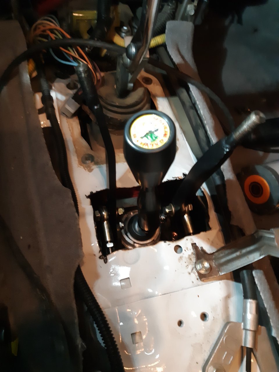

    With the body lift and mounts in, I started trying to work on the shifters and wiring.
    Heres a closer view of the clearance between the linkages and the body:
    Before making any modifications, things were actually looking decent. I had a little contact between 2nd gear and crawl box shifter in the forward position, and could not access reverse with the crawl shifter forward, but otherwise I was pretty happy with how things landed:
    With the center console:
    Time to get out the dremel and cut some plastic to make moar room.
    I bought a little harbor freight welder thinking that I'd be able to just pick up the gun and stick metal together. After some embarrassing practice welds I decided I should really try to score and bend versus cut and re-weld. I scored the crawlbox shifter on both sides and bent that bad boy, more to the left and forward. I scored both tcase shifters and bent them both outward. I also unbolted the trans shifter and flipped it over to the passenger side to give me more space between the crawl box shifter. I think they could all use to be just a hair longer so they are not as far down in the center console, but I can get to everything without shifter contacting or rattling. I have the space I need to get to reverse and 2nd gear so I'll call that a win.

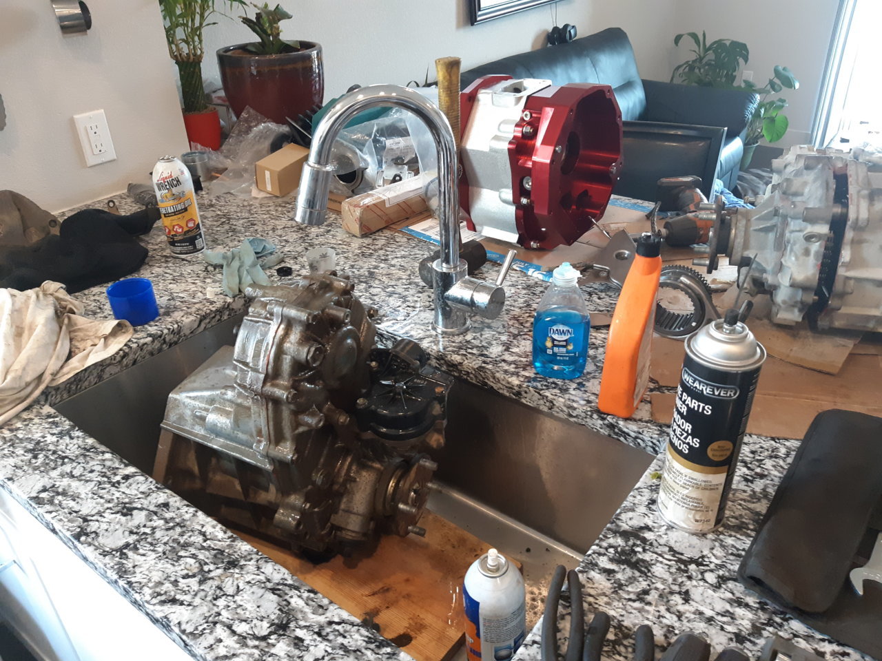

    I know we are skipping ahead a little with the step by step on the crawlbox...but heres a little teaser. Installing tonight!

    this is so awesome! would love to see kayla's face if i had that laid out on the counter :laugh:
    heading to rock therapy so we can have a turtle race?
    hoverlover likes this.

    I am down to the wire thanks to delays and fuck ups.
    How bout laying it out on the counter for 2 months? Lol. It's a cozy place to work.
    Dont think I'm going to make rock therapy...which is why I'm trying to get out this week. but we will see...could maybe swing a long weekend.
