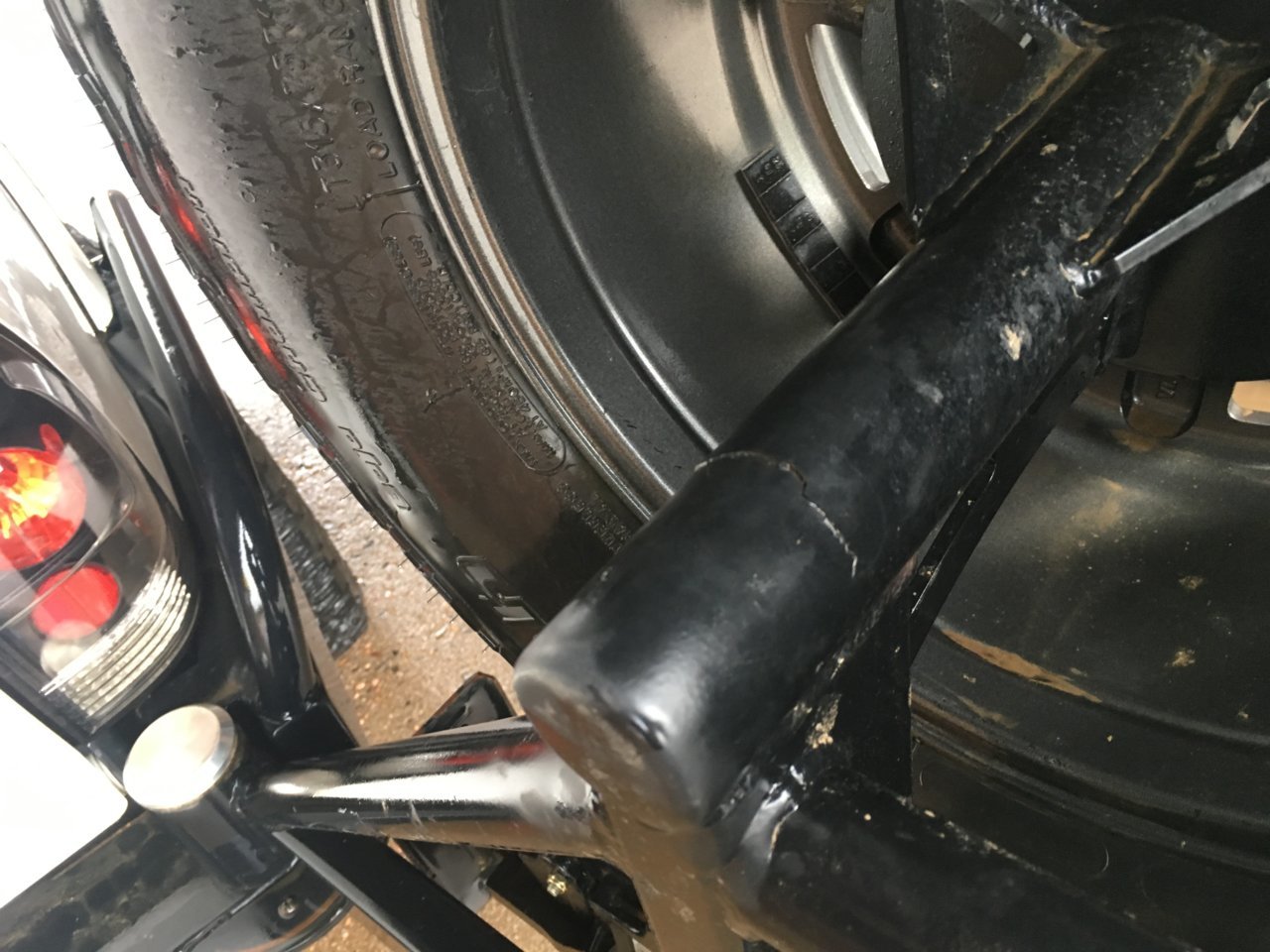

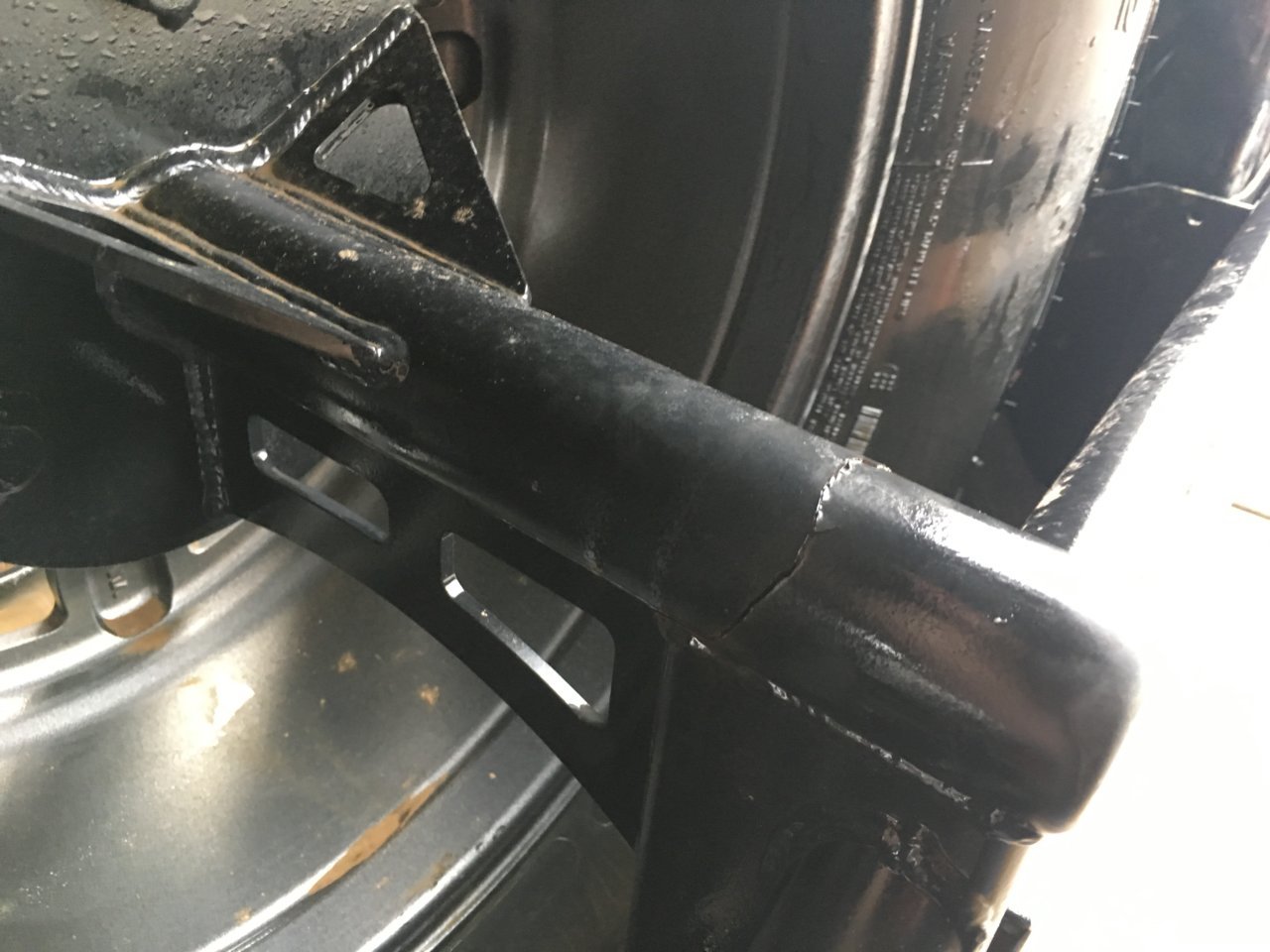

    Noticed my spare was a little shaky when I hit it with the power washer this morning....
    3932BF38-9852-40C9-929B-D9F24AEF9B51.jpg 23ED0FE1-F5CF-4B5E-8CAF-BE34338A3304.jpg
    Damn dirty fives are heavy!
    Tube is cracked about 80% of the way through. It would have fallen off already if not for the lower gusset.

    What hasn't been modified?
    Damn dude... you need gussets for your gussets

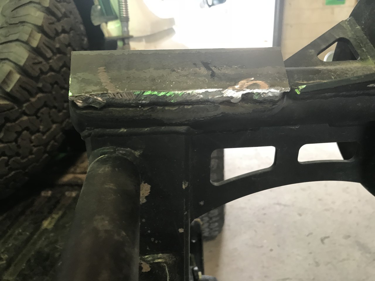

    Did you guys weld the crack too?
    Yepp, top and side of the tube even added to the old weld to the tube. Then grinder down the spots to make the angle iron to sit flat. Then welded it the whole length. Caught powdercoart on fire a few times also :bananadead:

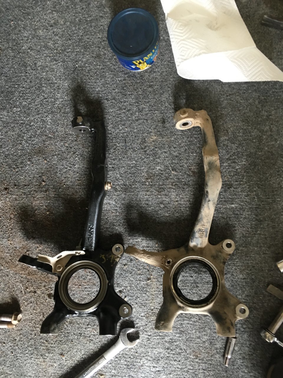

    New spindles? :confused:

    Just the passenger side. I nailed a rock last weekend and bent / twisted the shit out it. Flattened my cam tabs too.

    Spindle gussets... relatively inexpensive insurance against that kind of thing... ;)

    It’s probably time now with 35s. I honestly believe this one woulda cracked the weld and bent even with a gusset though.
    Cam tab gussets will happen first.

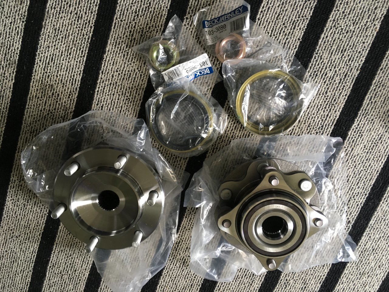

    New hubs going in Saturday!

    Woo! But you already replaced that dust seal on the one knuckle
