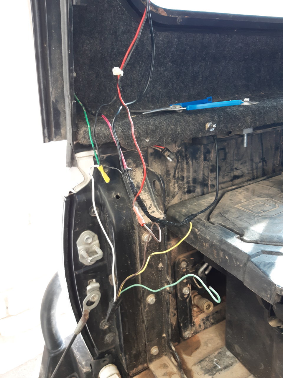

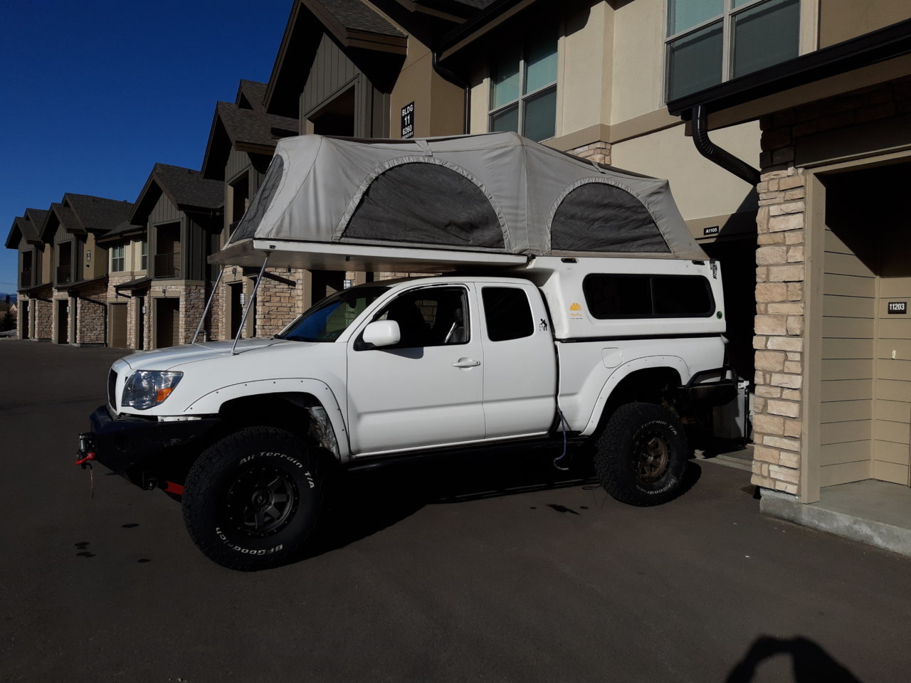

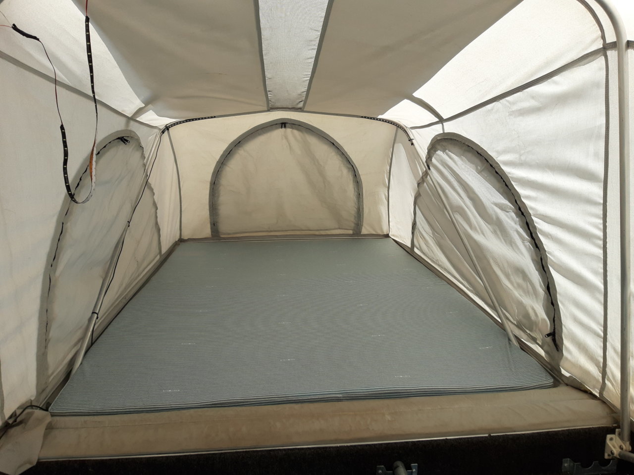

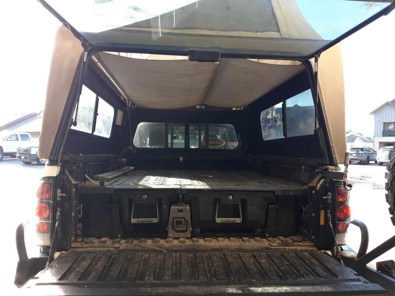

    Already bought quick releases to replace the connectors.
    Heres some pics:
    Some things I will need to address:
    Not technically designed for a taco so I need to close those gap.

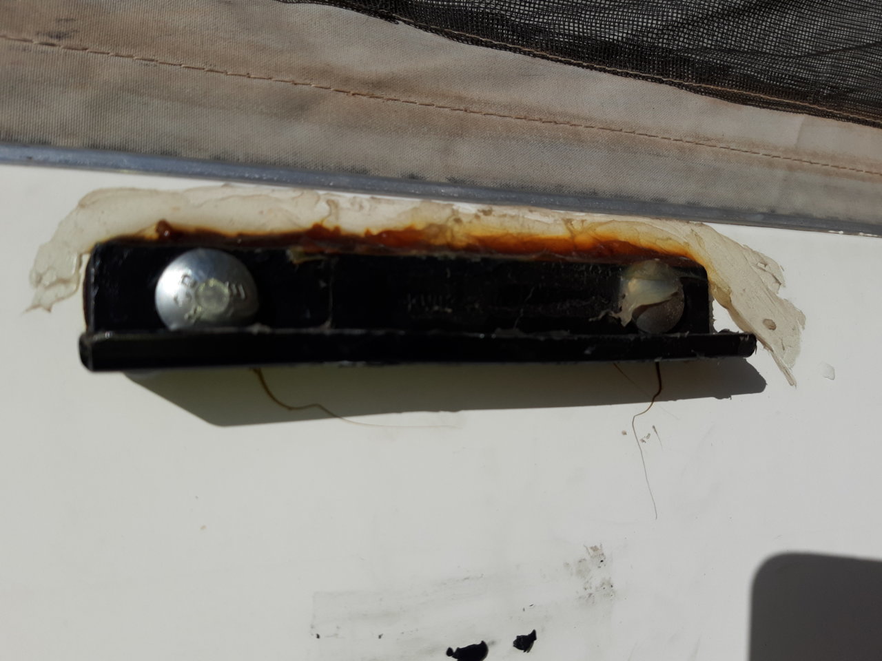

    Awning mounts will get replaced and resealed with something different...ideally a more versatile mount for gear or an awning:
    Some screens need love.
    o_O not quite up to my personal wiring standards
    Window seals:
    Also got a sink...wont quite work with the decked system but I will utilize the pump a d water tank at a minimum
    Oh yea, and I need a mattress. The one he had was too thick and he said it was uncomfortable.

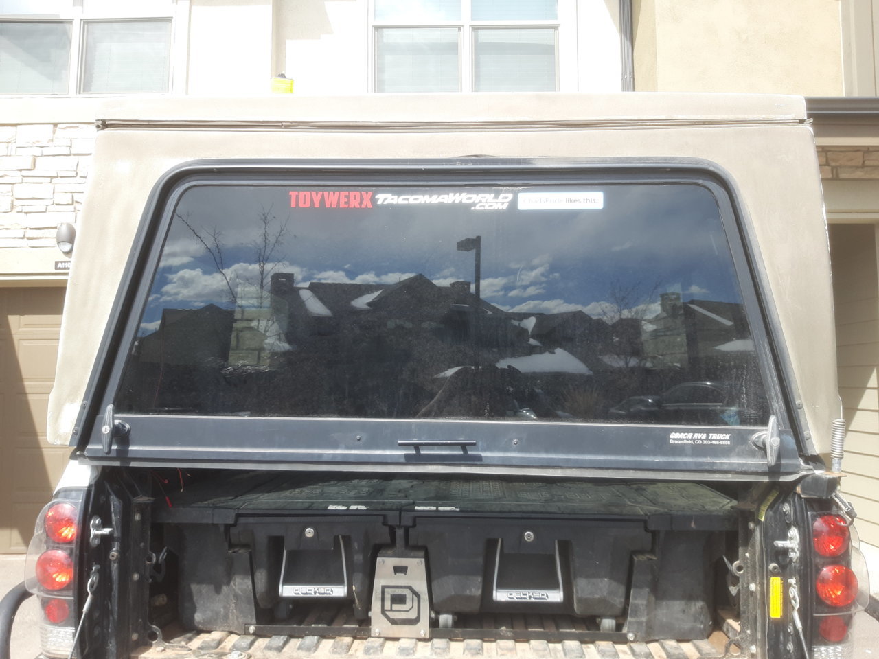

    It sorta gets organized before every trip, and then quickly disorganized in short order. Some folks like to have dedicated places to store stuff, but I am constantly changing what's where. I do need to label the boxes better. I can only tell my electrical box without opening it because it has the least amount of grease on the latches. This was my last Moab prep.
    Its honestly perfect for me like this. I have to tilt my head by the tailgate but have plenty of head clearance in the center. I actually need another step up to my sleeping quarters on the second floor of my mobile apartment. I can barely climb up even with the decked system.

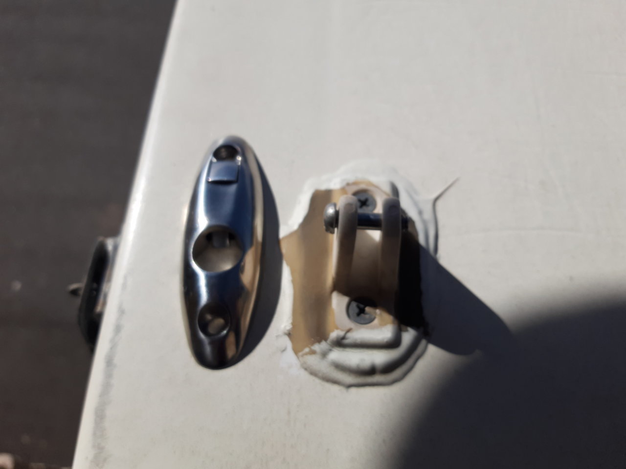

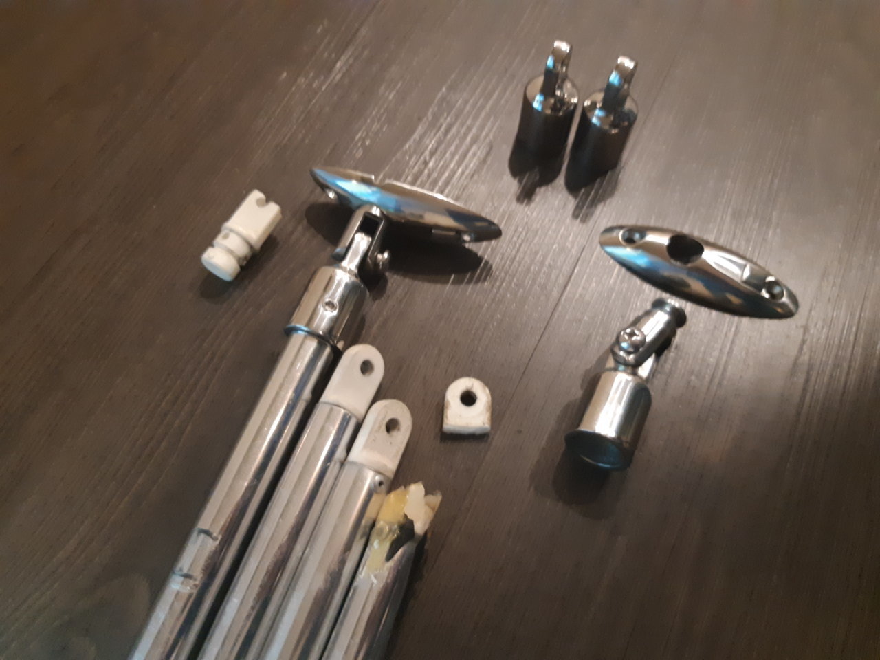

    Upgraded the hardware for the support rods on the flippac so I can remove them and install them without a screwdriver. Much nicer than the plastic ones that are prone to breaking and won't loose them to a tree branch on the trail. For one set of poles it's about a $70 upgrade.
    Quick Release Bimini Top Swivel... https://www.amazon.com/dp/B016CMI4Y8?ref=ppx_pop_mob_ap_share
    Amadget 2 PCS 3/4'' Bimini Top... https://www.amazon.com/dp/B073LTLY61?ref=ppx_pop_mob_ap_share
    A also bought a new mattress for the Flippac as well. The one that was offered to me with the camper was not original, and it was 4" thick, which is way too thick to fit in that shell especially if I am going to keep sleeping bags in there.
    I purchased online from Foam and More, a company out of Michigan. 75x54x2 of their luxury foam with a cover was $175 shipped. Fits perfect. Just need to get some velcro sewn on the back so it stays with the top when it opens.

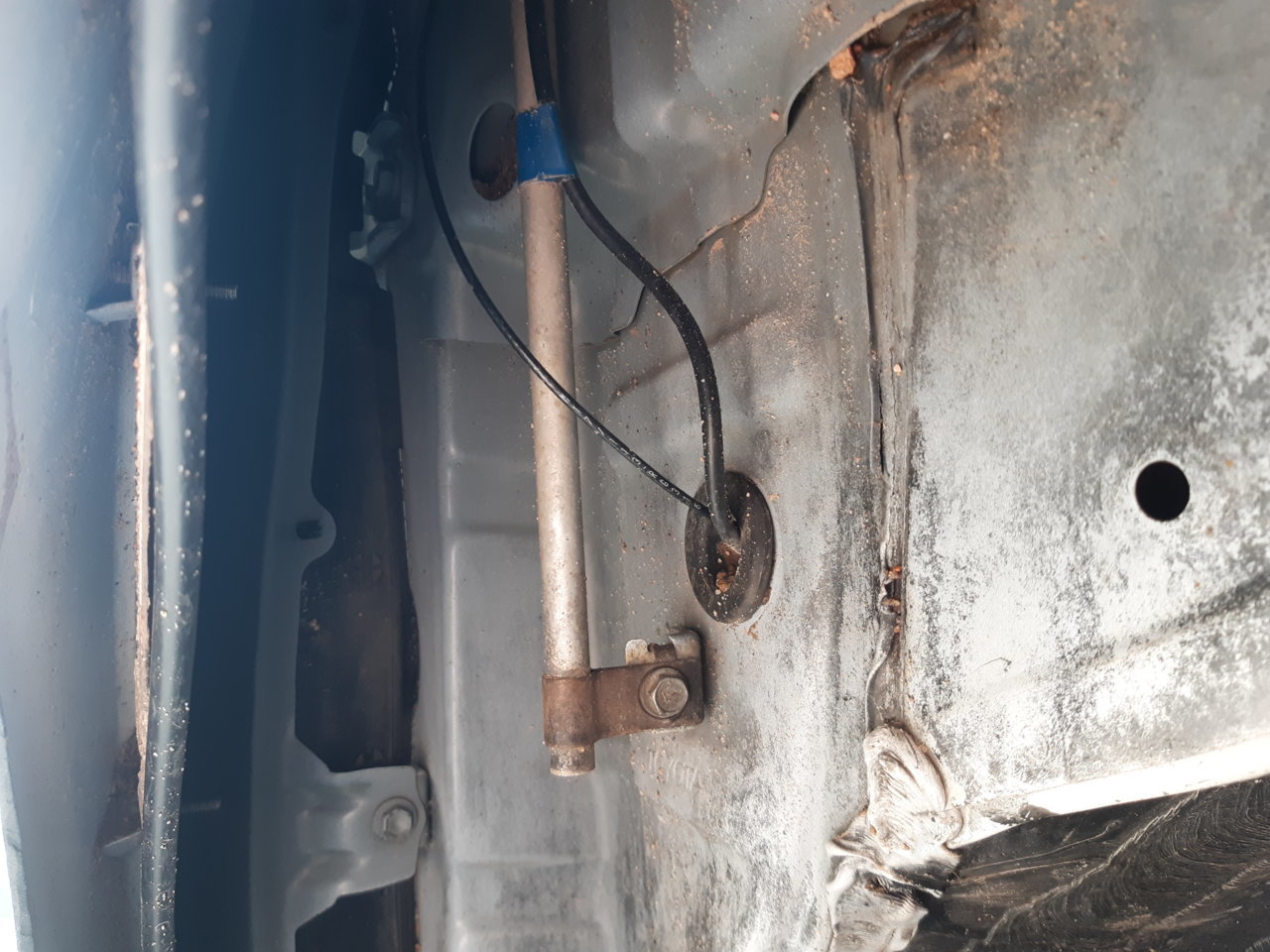

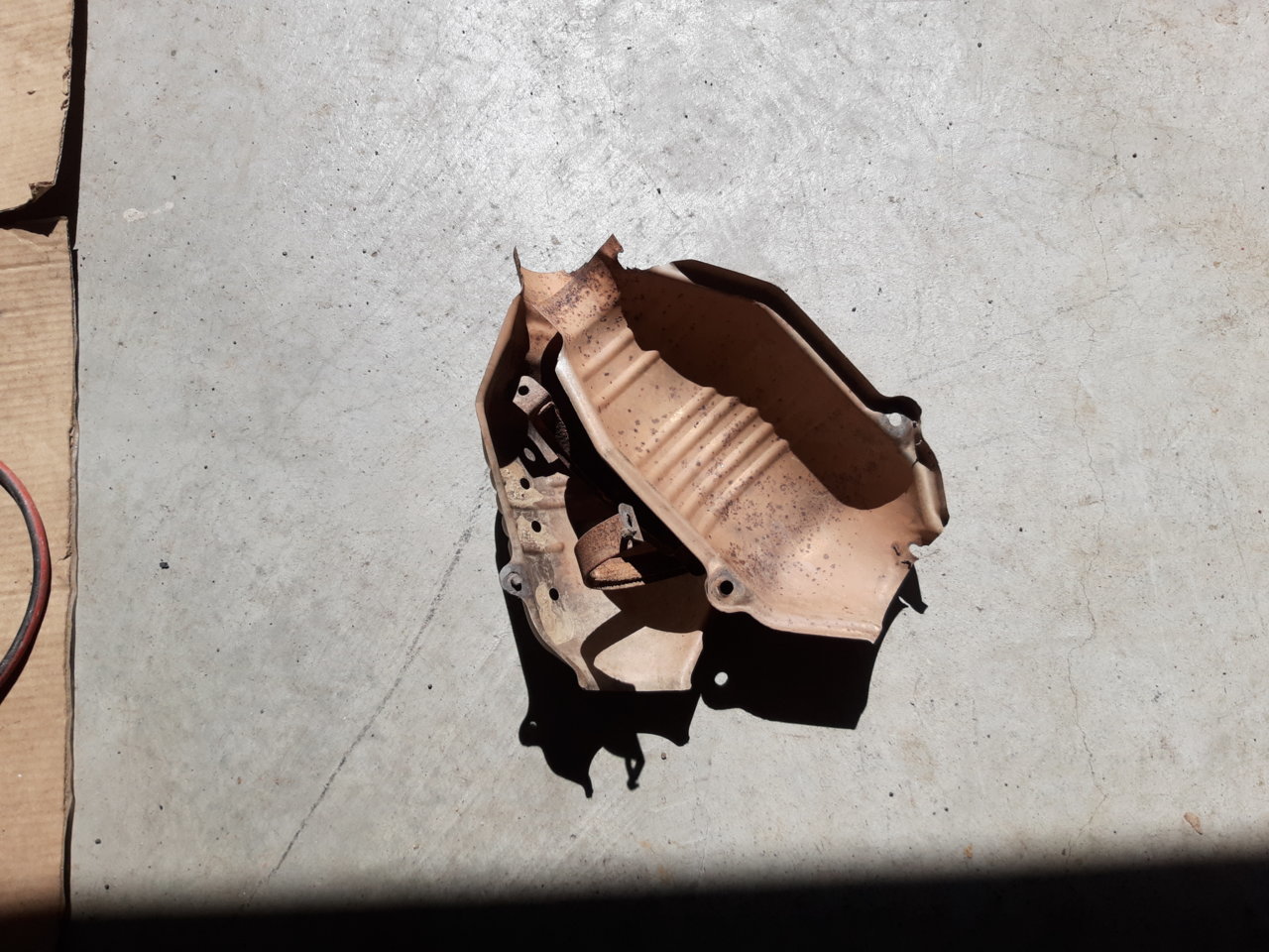

    I fixed my exhaust rattle.

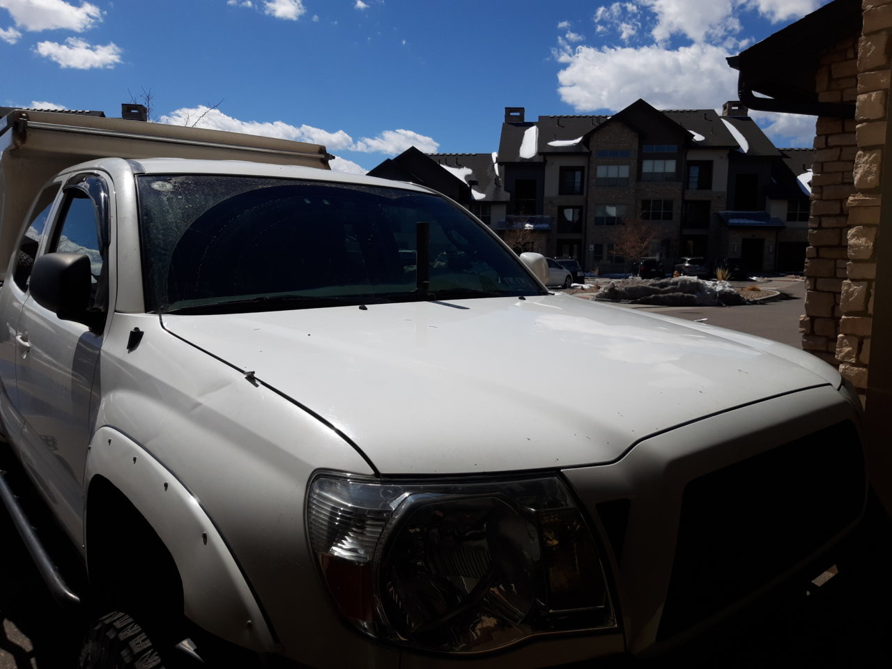

    Since I can't run a mag mount on the roof anymore with the Flippac, i am now running the big black dildo antenna on the hood lip. With a little patience I was able to squeeze the wire through the FM antenna grommet for a pretty simple, clean install.

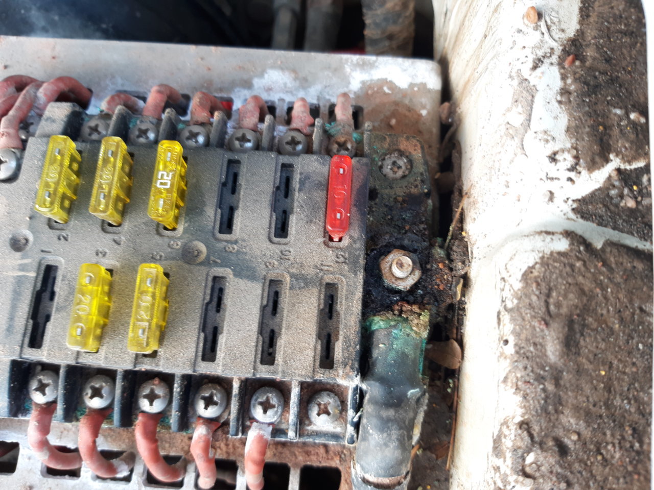

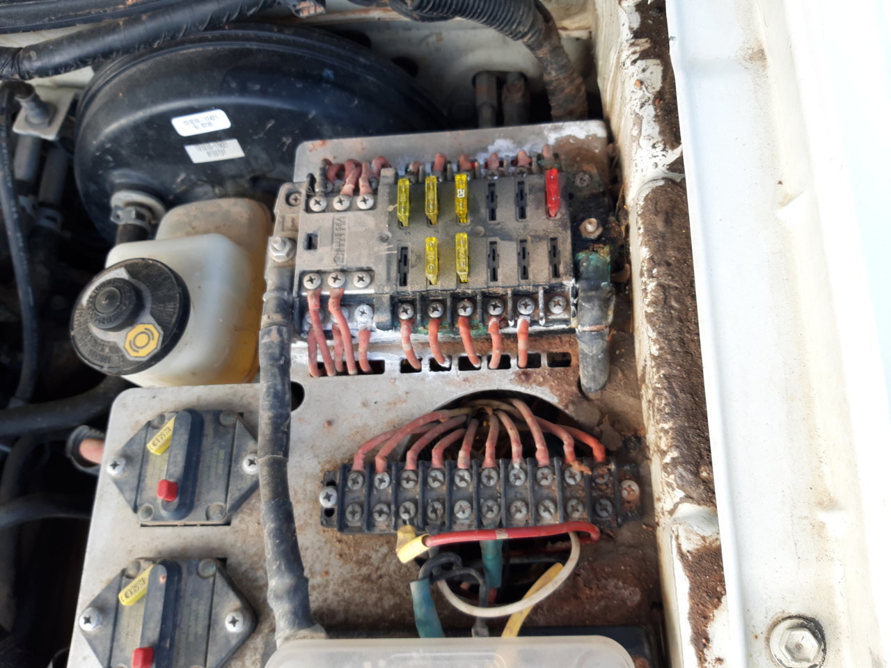

    I haven't gotten a chance to test the antenna yet because my dual batteries both mysteriously died on Friday. I have a feeling the culprit was a build-up of dirt and mud between the positive terminal on my fuse box and the inside of the engine bay that I haven't been monitoring as close as I should. I remember thinking this was a potential issue when I installed this thing and saw the orientation pelfrey had chosen for the blue sea panel on these mounting brackets. Would have made a lot more sense to cut the panel so that the negative was next to the sheet metal.
    At any rate, I think all the moisture from snow kicking up in there created a weak connection through the mud caked in between, and trickled the battery charge into the sheet metal of the engine bay. Theres no evidence of a fire or excessive heat, but the batteries were both reading 7-8 volts and had no cranking power.
    After running the truck all day sending 14.6 volts for like 6 hours straight yesterday, they are finally showing 12.8 and 12.5 volts again so all seems well. I will have to pay closer attention to the buildup here.
