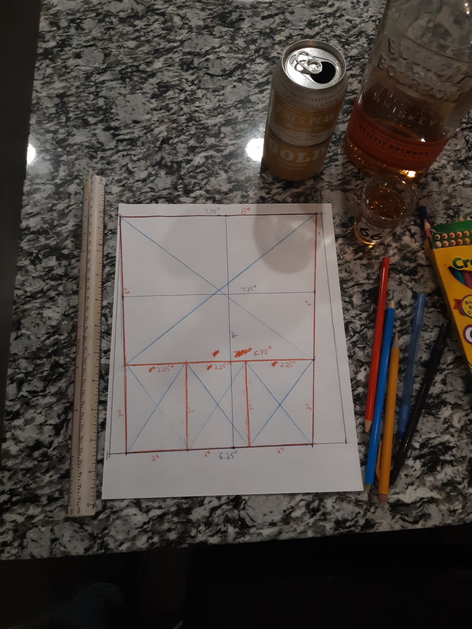

    @hoverlover @HomerTaco
    I have been dragging my feet on this stupid shift boot and I know I am over thinking the shit out of something so simple but give me a sanity check as I am applicating my geometric knowledges...
    The red basically outlines my proposed boot.
    Approximate length and width of the shifter opening is approximately 8"x9" overall, being wider at the top at 7.75" and narrower at the bottom at 6.25". This shit needs so be close, but not perfect. It's not a transmission adapter.
    I was thinking something like 2ish x 3" for each of the tcase shifters and a 8ish x 6" for the trans shifter? How does that jive with your boots? Should I make the tcase shifters 2ish x 4, and the transmission 8ish x 5?

    You’ll need a bit more than that i think

    A bit more than what? Which measurements would you change?

    You want an inch or more of material around the perimeter to be able to fasten to the center console.

    Gotcha. Yes, I'll have them cut the foot print a little wider for the entire thing. My biggest concern was the size of the individual boots, especially the small ones. Thanks Craig! :thumbsup:

    4" might be a bit short on the crawl box and hi/low levers, those have a ton of throw. I'll measure mine when I get back home.
    For certain, more is better. I thought there was sufficient material around the base of mine and I still pull it up and off of the trim when I use low range. Get as much in there as you can. The more mating surface area of boot to trim the better it will hold.
    Height of the triple sticks, I think mine are closer to 5". I'll get measurements when I get back home though.
    I measured from around the shifter base to the ends of the trim and added 1". You can always trim it; it's a bitch and a half to add more.

    For a little clarification on some of those measurements:
    The 2x3 vs 2x4 (width x length) measurement is on the square footprint of the rear shifters, not the vertical height. I honestly don't think that the footprint makes much of a difference as compared to the vertical measurement (as you pointed out) which is what gives me the material I need to allow the shifter throw. I measured all three rear shifters from the back of the opening to the knob with the shifters in the forward most position. The largest throw was 6.5" on the crawlbox and 4wd shifters, 5" on the FJ hi-lo. So I figured minimum 8" vertical height on the rear shifters should allow the throw I need, plus will make the overall footprint slightly larger by about an inch as you suggested.
    For the trans shifter I'm going with the factory boot measurement of 11" on the longest diagonal. I double checked that against actual measurements of the shifter in 2nd and 6th, which was like 9" so that shouldn't need to be lengthened.
