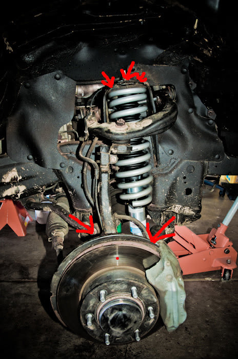

    I had problems with my Toytec lift from day one.
    I call Toytec and explained the issue and there reply was that all trucks are not the same, but they clam the lift i got from them was pre set for 2.5" and when installed it turned out to 5" of lift. I bought the lift because it was supposed to be a bolt on and was under the impression i wouldn't have any other cost once installed but i was wrong. I had to pay a shop to adjust the coilover down almost to bottom of the adjust ring to get 3". Just something for you to think about before you spend the money for a coilover from toytec.
    I spoke to toytec about this issue and sent them pictures and i was told everything looked fine except the lift was only safe up to 3". If anyone has had a problem like this please let me know.

    Post a picture of the coilover. If it is cranked up to high, it is going to ride rough.
