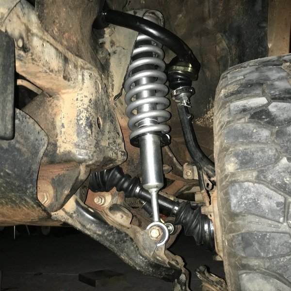

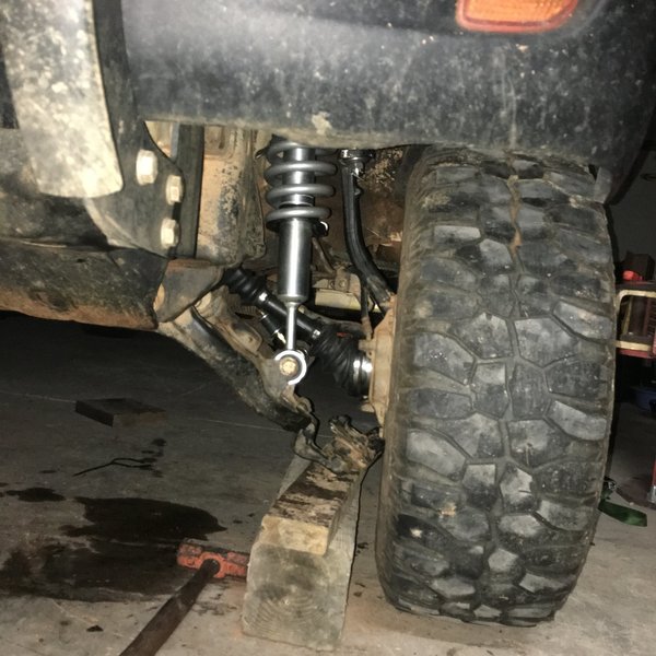

    The pics with the tire on are the drivers side. You can see how much it lacks from meeting the bottom of the spindle. The pic with my hand in it is the passenger side and it's hard to see but you can almost see lower is almost horizontal. One of my best buds (one helping with the install) called his brother in law and he agreed something isn't right and he's installed several within an hour or two.

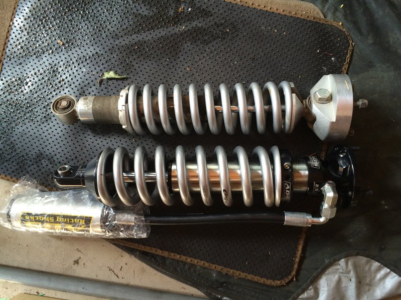

    Wait. Do you have a second gen shock? Mine look like this. The top one is from Toytec.

    Cause normally 2nd gens have that long skinny part on the bottom. I could be wrong though. Where'd you get this setup from?

    Those are the adjustable coilovers. Those are just 5100s/eibachs

    Something did look off. Looks like 2nd gen stuff.

    Think your trying to install a 2005+ kit...

    Like I said, I could be wrong, but it looks like 2nd gen stuff. But I AM used to seeing all the Adjustable COs all the time :laugh: I just know when I saw 2nd gen shocks I always thought they looked unusually thin at the bottom.
    Where'd you get this stuff from? If they are first gen stuff, try putting a jack below the LCA to raise it up.

    That would explain a lot. 2nd gen as in the coil itself? I call myself double and triple checking and it was calling for the same year model when I ordered it

    Looks like 2nd gen shocks going on a 1st gen. Might not work

    Yup. That's for a second gen. Wont work on a 99.
