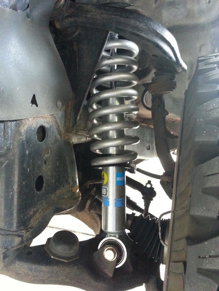

    Where'd you order it from and do you have the part numbers?

    The shock is what I'm looking at. Notice on the bottom the little skinny pole part? First gen shocks generally don't have that. The eyelet connects to the fat tube part itself if that makes sense.

    I ordered the springs directly from Toytec but I found the bilsteins about $39 cheaper on the Internet so j bought them seperate

    Should look like this for first gen when installed

    Ya. I'm thinking you ordered the wrong items dude.

    In that case its just a matter of exchanging the shocks.

    Have a part number on the shocks?

    If those are the correct struts, check if your inner axle joints are seated... If they pop out you'll have a hell of a time trying to put that lower ball joint back together..

    Perfect. Thanks for the help. I knew something wasn't right. Makes sense. I was worried bout the struts. I already forgot the site but it was super generic and not real vehicle specific and my original concerns were correct. Hey bill^ thanks man. The smart ass response didn't sit to well after wrestling this thing more the day. Anyone need bilsteins for a 2nd or 3rd gen? Whatever the hell they fit

    If they bolt up top and bottom and you can't return or sell em you could try them on the lowest clip setting first and measure how much lift they give...

    It wont work.

    Yup correct parts are always the best... Besides the first gen design looks way beefier... Skinny bottom looks like a failure point...
