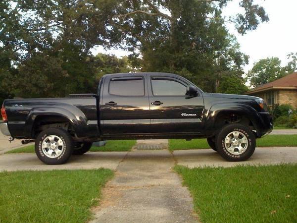

    Well i was finally able to get the 3" lift i have been wanting since i joined this website! This website, and modding is addictive!
    I know now that i need bigger tires..probably some 285 A/T when i can afford it. But for now ..at least i got the lift!
    Pls tell me what you guys think and how it looks! :D
    Before -
    :) AFTER -

    looks badass! i cant wait till i get mine on

    Will get the toytec next year.trying to wear out my 3 inch revtek for now.your truck looks good and i'm sure the ride is smoother than mine.it'll look better when your bigger tires come.

    Sweet lift. Did you get the Ultimate kit? I hoping one day I'll be able to lift mine. I was wondering how a 3'' lift would look with 265/70/16s.

    thanks bro- I didn't get the ultimate kit..
    This is what i got-

    This is a spacer lift, correct?

    No as far as i know. I discussed it with the shop that installed it.
    FRONT: (2) OME 884 standard/light load front lift coil springs
    REAR: (2) 2" lift ToyTec Add-a-leafs by Alcan spring (a long add-a-leaf for the best ride), w/OEM style anti-friction Pads, & new leaf spring center pins.

    To be honest, I think the 884's will sag over time. :eek:
    The 884's were designed to hold the weight of the Access cab, and not the double cab. The 885's are for the DC. :eek:
