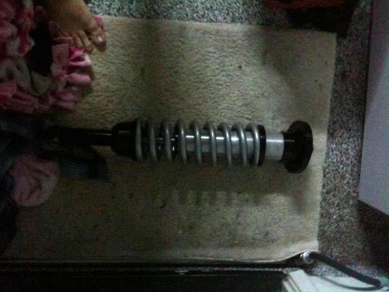

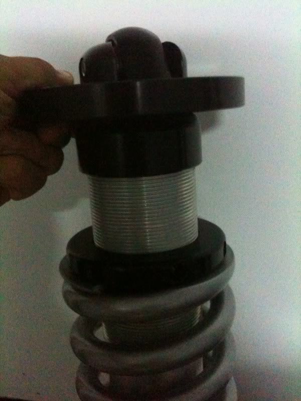

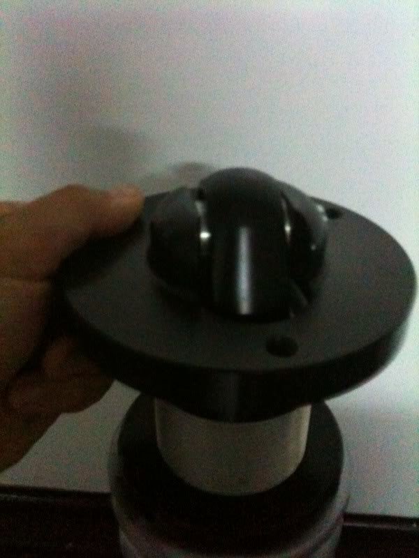

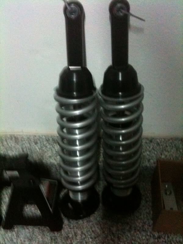

    Go with Leepers, much better quality. They are Donahoes without the branding since donahoe and the manuf. had a falling out. Here are pics: $500!

  10. Jun 10, 2010 at 8:50 PM

    Those include anything for the rear?

    Nevermind. So those and 2.5" AAL's would do the trick?

    yup, 89 $ or so from toytec for the add a leaf

    compare the $500 for coilovers against what you'll pay for non-coilovers, lol. For like $100 more its such a better product and gives you flexibility for the future
