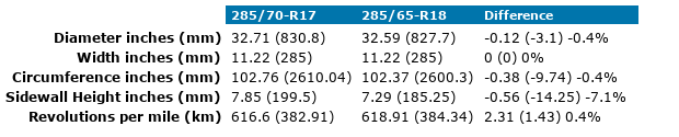

    To start, I am new to this forum thing, and i know people get aggravated when somebody asks questions already answered. BUT, i've searched and searched and still cant find the right answer.
    I have an 08 tacoma, double cab. I'm buying the Toytech 3 inch lift kit with bilstein 5100 adj. coilovers.. I want to put 18" rims with a tire close to 33".
    Almost all the threads i've read have been about people putting 285/75/17 on.
    If anybody could just clear up what tire size would be the best ( closest to 33" ) for an 18" rim, I would GREATLY appreciate it!
    :confused::confused::confused:

    actually for a 17 it is a 285/70/17 and the 16 is 285/75/16 so therefore you would want a 285/65/18 :cool:

    Only if he had specified width :rolleyes: looks like either way he goes its the same lol ones a little taller and ones a little wider :cool:

    X2. I ran 285/65/18's and they looked great.

    Wow! That was really quick, thanks everybody for the input. Looks like ill be going with the 285/65/18. I guess my next step would be to figure out the right offset for the rims so I don't hit the control arm... I'm pretty sure it's -12??

    18x9 4.5 backspace with -12mm offset
