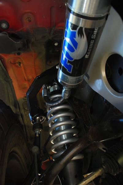

  16. Apr 23, 2012 at 9:49 PM
    #16
    brian
    brian Another Traitor
    Apr 15, 2009
    #16011
    7,551
    Elizabeth City, NC
    2017 F-250 Powerstroke
    You crank up your coilovers and it will be stiff. I run my coilovers around 2.5" with 600 pound springs and its a tad stiff, but realllllly rides nice offroad. On the flip side, I have a friend who bought 700 pound springs, and is cranked for 3" and there is absolutely no give in his front suspension... he bought it in anticipation of getting a bumper, since they are quite heavy... just hasn't gotten that far yet.
    Honestly, if you're gonna go without a bumper I would almost suggest a 550 pound spring or maybe even less to maintain a nice ride and full travel. Get a really nice shock and you'll be set for offroad. My quarrel with my setup is with the preload, I don't have very much up travel when I go over obstactles. I'm not complaining too much yet since I haven't done a cab mount chop, I don't really want to stuff them and rub em.
    Its a personal preference to me, if I didn't have the idea of getting a bumper in the future, then I might have gone with lighter coils.
    My setup. Foxes.
