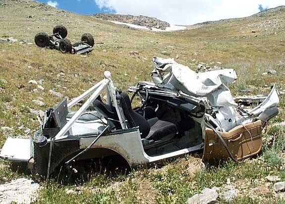

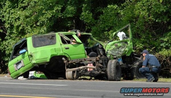

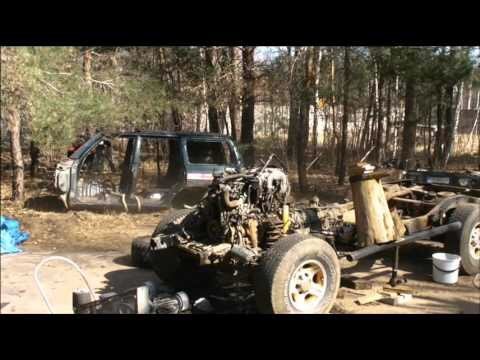

    In the event of a crash. A body lift puts higher than designed shear forces on the body mount bolts. There are only six bolts that hold the cab to the truck. Six. Two of which only have 14mm heads. IMO, it's not worth the risk. But to each their own.

    LOL! Not from my yard! Each one of those photo is the accident aftermath of a truck with a body lift. There is tons of examples of this out there.
    First hand knowledge? I've never driven a truck with only one lug nut on each wheel. Does that mean I can't say it's a bad idea? Never had first hand knowledge with body lifts because I personally wouldn't install one due to the obvious mechanic disadvantages imposed on the mounting hardware; and from what I've learned from listening to (and not dismissing) fellow off-roaders.
