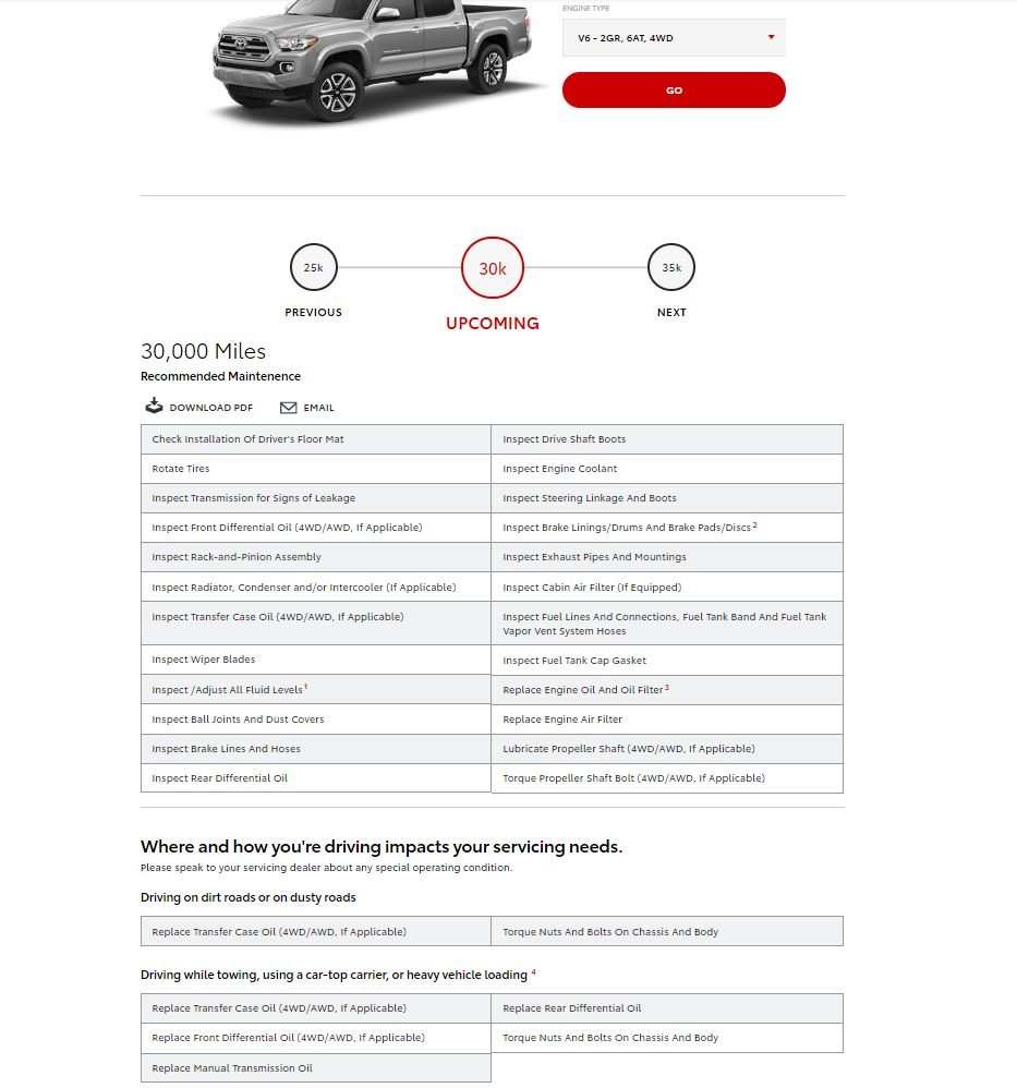

    Here's from Toyota Owners website, you can go plug in your vehicle/mileage and see the maintenance schedule.
    GreyBaldTaco and Thorian[OP] like this.

    30K should also include front and rear differential gear oil change.
    All service intervals should include tire rotation, driveshaft Zerk re-grease, and shaft/spring bolt re-torque. You can certainly do it cheaper DIY, but it'll require some work, semi-specialized tools, jack stands, and time.
    $290 seems about right if you get all of the above. YMMV, depending on the dealer.

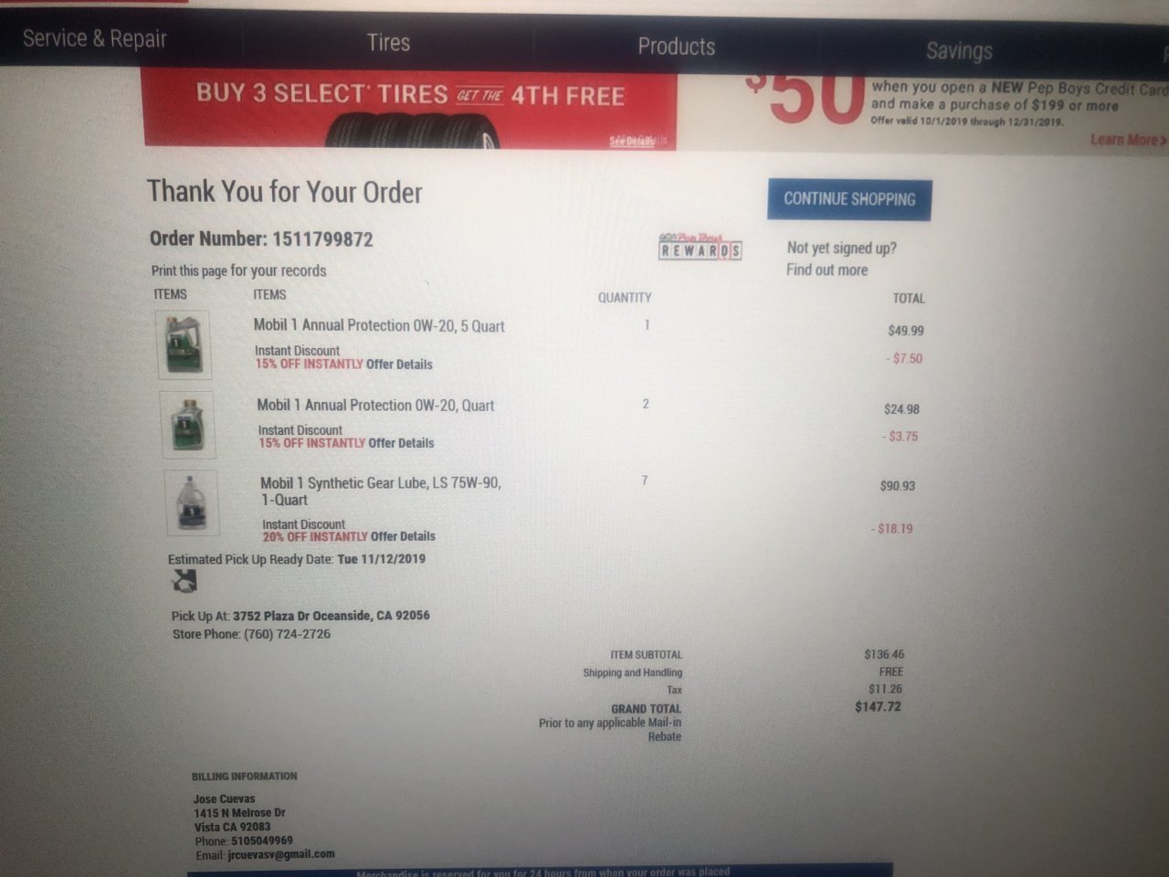

    i am about to DIY my 30k service. Toyota of Carlsbad quoted 1799$ for it including the T-Case, front and rear differential oil change. I had to laugh and walk out.

    You can do all those yourself for less than $100 total with the best synthetic fluids. I’m sure you know

    about 150 only in fluids with 1 extra qt of engine and gear oil to keep with my trail fluids.
