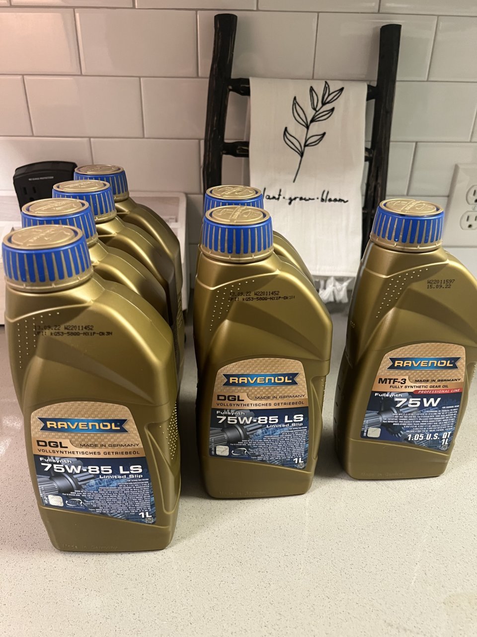

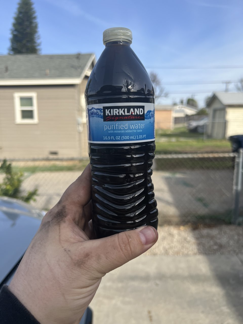

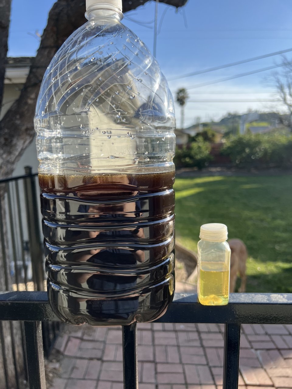

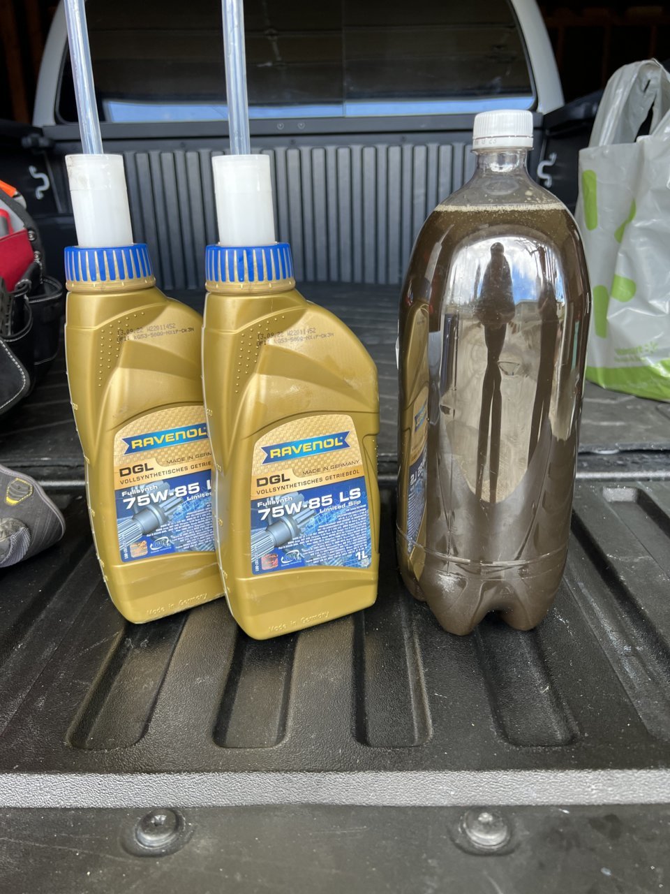

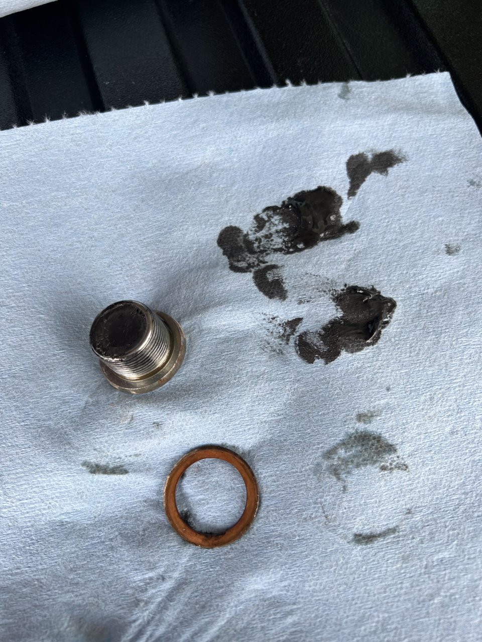

    Changing the fluids was on my mind as well. When I crossed 50k I decided to make a point to get them done. I highly recommend the YouTube channel team oil drop! Changed my power steering, rear diff, t case, transmission, and front diff in two weekends… at a pretty leisurely pace! Diet Coke in hand
    Best part, didn’t have to jack up the truck. Much different than my previous car… Mazda 3
    Before and after with the power steering. Whole project cost me 2 quarts of ATF. I ran one quart through with the hand vacuum pump to “flush”. Probably not necessary?
    D5FB0833-2C93-47AA-BE34-CB31246BF6B1.jpg A8175A93-CDD8-4452-9F2D-8B0E2EEC8588.jpg B4BBADD1-7545-415E-9D42-53BF73A3DD81.jpg

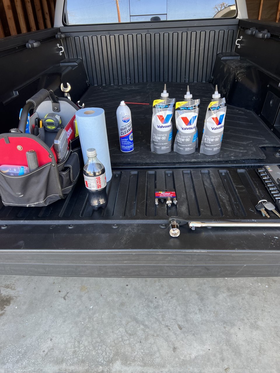

    My truck is a manual transmission. So I can get away with the 75w-90 and a simple drain and fill. I understand those Automatic transmissions are a bit more work? Whole project took me 20 mins..
    AF1AC69D-2BEB-458D-B6E6-34CF22090906.jpg 14FA6873-6367-4E60-B37E-7F3BDAA38328.jpg
    I bought this Ravenol kit online. Comes with the specific weights and quantities for the differentials and transfer case. This 75w-85 and 75w stuff isn’t readily available…. and these damn dealers want over 100 bucks for a liter of t-case oil… na fam. This whole kit was $150ish.
    3B4C7F5C-D436-447A-982B-17AF1CBE35D1.jpg 49C6067B-A061-42B5-AC4F-25199FCB85A3.jpg
    Here is some of rear diff oil. Not all pictured. You’ll get 4 quarts out if you have 4wd and locker.
    Pretty sure this was from the front differential.
    All in all this was stupid simple. Hardest part was the front differential. Really just because of access. I didn’t jack up the truck/pull wheels which would have made access easier. I think I’m into all these fluid changes around $200 bucks and 3ish hours of my time. Worth it in my book.
