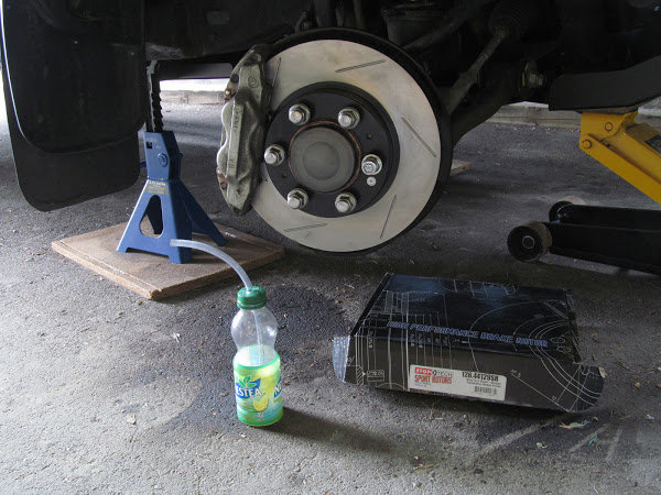

    No. I followed this video and it worked fine for both my current truck and my previous 2nd gen (both TRD OR):
    Only difference is you do it with power on, engine not running (key "on" or two presses of the start button). Press the brake pedal and the electronic booster will pump fluid into your bleeder bottle.
    My bleeder bottle is a Nestea bottle with a hole drilled in the cap for 1/4" silicone hose. Over time the hose will harden - basically need to be replaced every 3-4 years before you do the brake flush.
    g5DYOs6EjuK1NknhL27pijolGl2fHOJyuzsvFUyX_b74f11d29d1cef10d3779f9ae94a0baa6d656a43.jpg
    TechStream is likely needed if you ever replace the electronic booster and need to bleed it. Same with non-OR trucks when you replace the ABS module.
