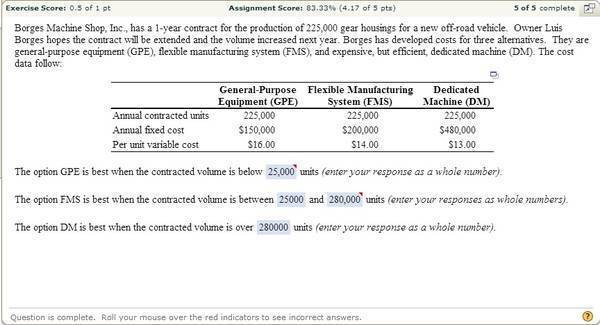

  14. Oct 14, 2013 at 12:28 PM
    Monster Coma
    Monster Coma Well-Known Member
    Jun 15, 2012
    #80740
    26,279
    Corey
    Pittsburgh, PA/Houston, TX
    Sponsored by Mom and Dad
    Can someone help me with this problem? The correct answers are provided but I dont know how to get them.

  18. Oct 14, 2013 at 12:51 PM
    Monster Coma
    Jun 15, 2012
    #80740
    26,279
    Corey
    I need to create a line chart but dont know how to online to get an accurate count.

  20. Oct 14, 2013 at 12:58 PM
    MowTaco
    MowTaco Well-Known Member
    Sep 9, 2009
    #22530
    3,814
    Kansas
    16 Chevrolet Silverado
    Just make a function for each of them, so if you were to graph it the x axis is #of gears produced and the y is your total cost, so
    GPE= 16x+150000
    FMS= 14x+200000
    DM= 13x+480000
    You don't really need to graph it to figure it out, just set GPE and FMS equal to each other and solve for x (comes out to 25,000) and then FMS and DM equal to each other (comes out to 280,000). This gives you where the lines intersect (so where the costs are equal)
