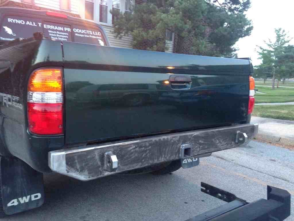

    My new rear bumper will be something like this with a wrap around and tire carrier I think. Basic but useful.

    i know your first round of bumpers were god awful hideous, but if you made that with wrap arounds (dont need the tire carrier) i would buy the shit out of it!
    at the same time though, making a bumper like that isnt too hard so it looks like something I would want to do, because I like making shit. it would just be nice to have a good ol cnc machine. do yo have access to one? if not what do you think is the best way to get the straight edge cuts on the angled pieces? where do you get that a hitch receiver you welded in?
    i dont want to copy your bumper, but thats the exact same style i would make mine, simple, solid, doesn't stick out far, so im bombarding you with questions

    you don't need a CNC to make that bumper. Super simple. Just a rectangle tube. Cut wedges out of the ends and bend them up to make the angles. Just cut out caps like normal. You can get pre made frame mount plates from eric at Relentless for cheap. Cut the slits for them and the recovery receivers a crossmember and reinforcement. Bit of tubing bent and and your pretty much there.

    :cookiemonster: well fuck me, that exists? i thought i was going to be just making pieces. hell that got a lot easier haha!
    might build me one before moab
