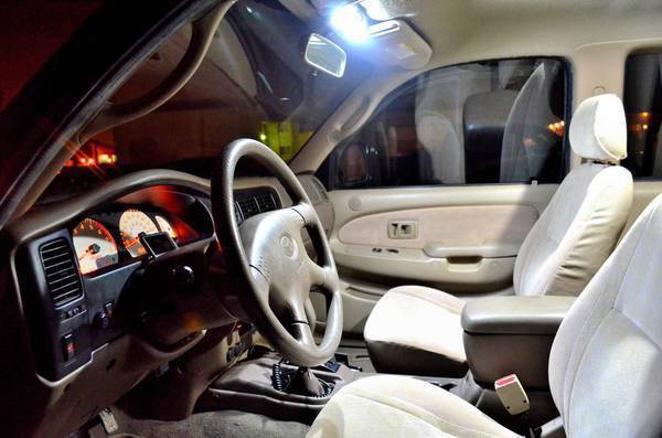

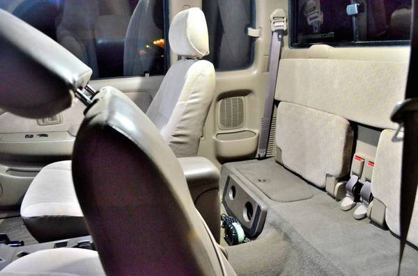

    Everybody should do this mod! :eek:

    Do it! Haha I still have to put resistors in them, as of right now they only work with the key in the ignition. Easy fix though.

    Those are the brightest interior lights I have ever seen

    I like them. :D

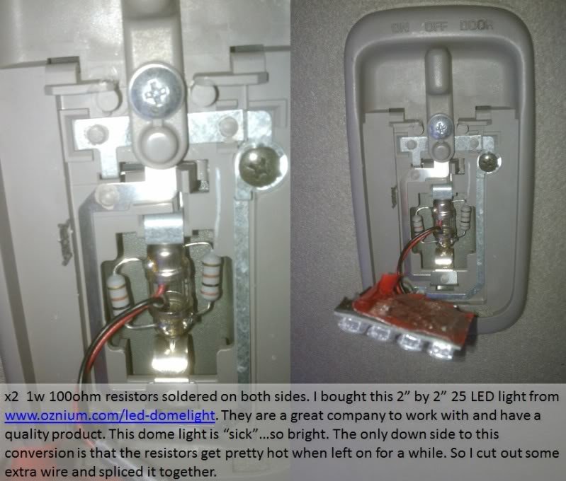

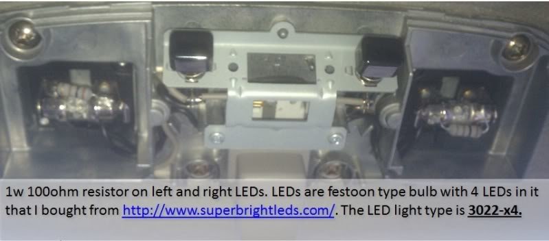

    As a warning to everybody that decides to get these. They DO NOT work without the key in the accessory or on position. You must wrap/solder resister on the connections like so for them to work like the stock bulbs.

    Just remember that they won't work without the key unless you put resistors on them ;)
