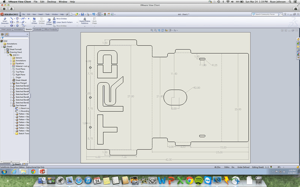

    looks nice Ryan but wont the TRD cutout make it weak?

    Thanks. It's a little weak there I'm sure, but like I told someone else, rock crawling in Iowa is non-existent and I don't like to beat on my truck anyway. I would rather slowly slide over an obstacle than hit it hard. Mostly just awkward curbs or small children. I put it as high up as possible since most impacts would probably occur down by the diff. I'm not going over something that would hit it up high since I have other parts to worry about too.
    But if it turns out to be too weak, a support plate could be welded on the top side of the skid I suppose.
    Edit: and for what it's worth, the inside of the R that is still steel is a minimum of 1/2" wide, so it still has some integrity there.

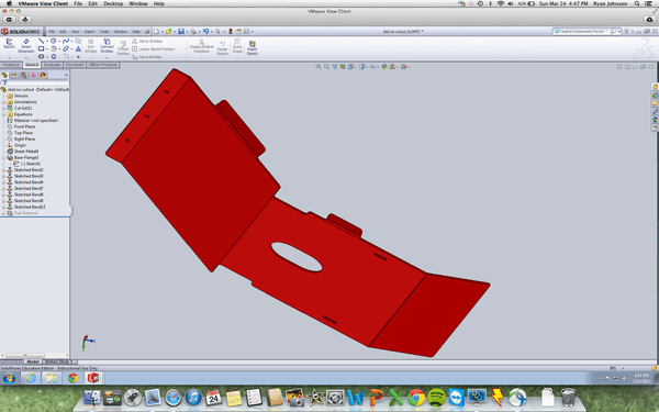

    For pcbuilder

    I like it... Have you decided how thick of steel to use to make it?

    3/16" of course. I can do anything actually but that's the most common for skids. About 55 lbs. High strength 3/16" is about $20 more I think but I can do that too.

    That's a nice looking skid plate. Wanna make an extra one and send it to hawaii. Lol

    Silly 2nd gen, this skid is for firsts.

    Cool, what would the price be on one of these things?

    Less than $200 before shipping. I'm hoping around $150 but it depends what I can get them bent for. I won't be getting rich off these prices but eff it.
