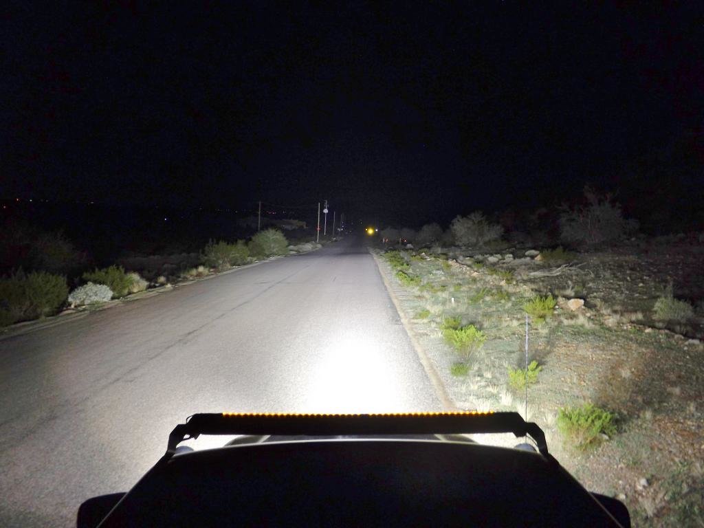

    LED bar only
    LED bar and headlights low
    LED bar and headlights low and fogs (best overall output I think)
    LED bar and headlights high no fogs

    Can you post a front pic showing the grill and LED bar turned on?

    Sure, here's a bunch of pics of it on from the front etc.

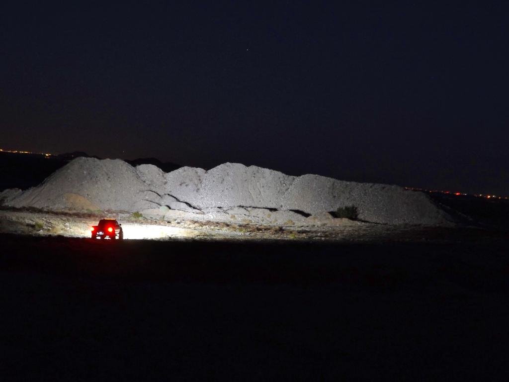

    My setup:
    42" Evo Prime clone: 10watt led's (roof) 22,165L
    20" Evo Prime clone: 10watt led's (bumper valence) 10,320L
    Two 8" Evo Prime clone: 10 watt led's (bumper valence turn signal area) 3440L ea.
    Two Rigid srq ambers (used as dtrl's) (hood)
    'MRT LuxMaster' led cannons(vision x clone): 25watt led's! (On CBI ditch light brackets) 1800L ea.
    TRS Mini H1 projectors (2200 lumens each I believe)
    Again, the best shots I have are TOTAL output of everything. I really need to get some separate shots of each bar. I can get one of the 42" by itself if you want...
    (1st pic is without the led cannons. 2nd is with, but doesn't show much increase over all the other bars)
