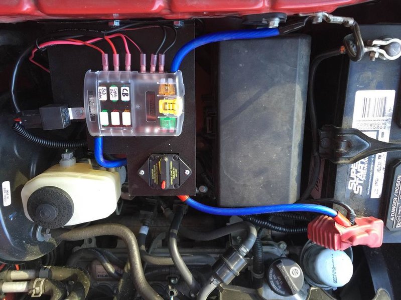

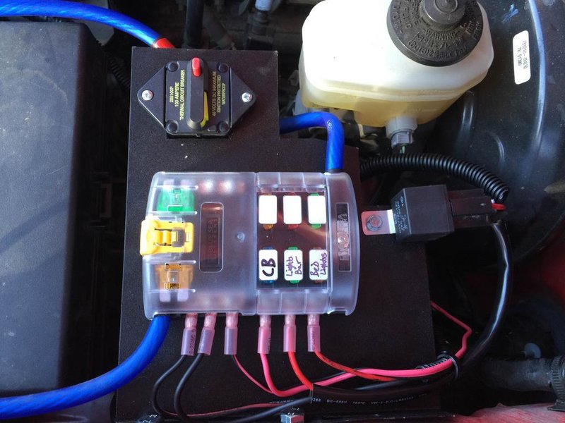

    Thanks guys! I also cleaned up the wiring last weekend. Installed a Blue Seas Fuse block, circuit breaker and mounting plate.

    Nice, a relay box is next on my long list of want to dos

    whats the relay for on here? ive figured out the rest of the setup, just dont see what the relay does.
