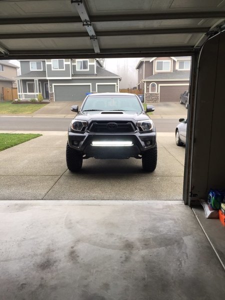

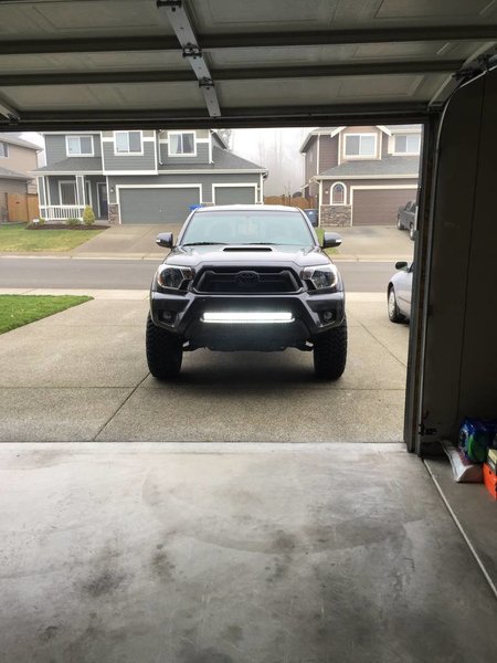

    You don't need to do it. I only did it to clean up the mess that was starting to show up from having all my accessories on the battery. It looks a lot cleaner! If you were to only put the light bar on I probably wouldn't worry about it. But its your decision!
    I think some guys on here have put a 32" in the lower valance, mine is a 30" and yes it came with its own brackets.

    Mine is the avec light bar 30" behind the valence without any cut outs. Basically what I did was hand tap my threads into the crash bar for the mounting bolts. Also have a otrattw switch. I didn't mind it being able to be turned on with the truck being turned off. I also tapped my switch into my fog light switch to have the capability to dim or brighten the switch bottom light with my dash lights. Love the set up and switch. No one even knows it's there until I turn it on!

    I have a 30" behind my lower valence and mounted it to the crash bar and it fits perfect and it doesn't affect the lights at all. Didn't have to cut a single thing. You can even stand in front of the truck and the light stay fully illuminated. I don't have lights behind my grille though.

    Front bilstein 5100 with OME 884 w/trim pack, 17" fuel trophy wheels wrapped with 32" toyot open country m/t, bakflip fibermax tonneau cover, Avec 30" led light bar behind lower grille, marathon seat covers in max 5 camo pattern, trimmed front and rear mud flaps, more to come.
    I have a 14' and with the 30" the bar itself comes to the edge of both sides. IMHO I think the 30" is the length that you would want to go if you want to utilize the full bottom valence. I'm not sure about the earlier years but for my truck I think that a 32" would have been to wide and some of the light would have been cut off by the valence.
