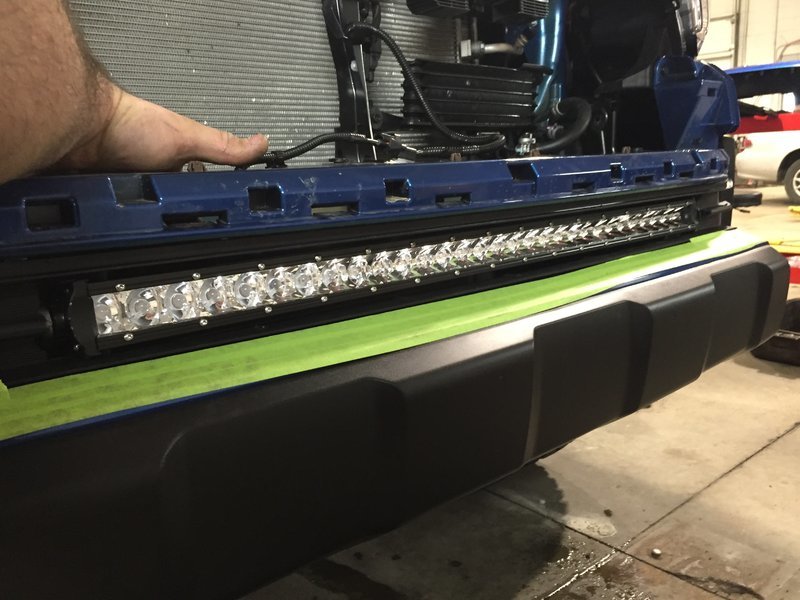

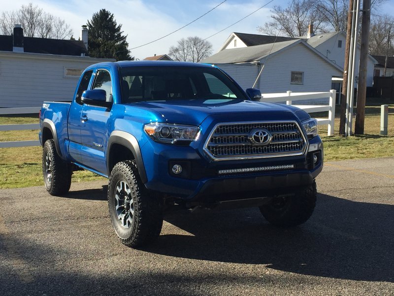

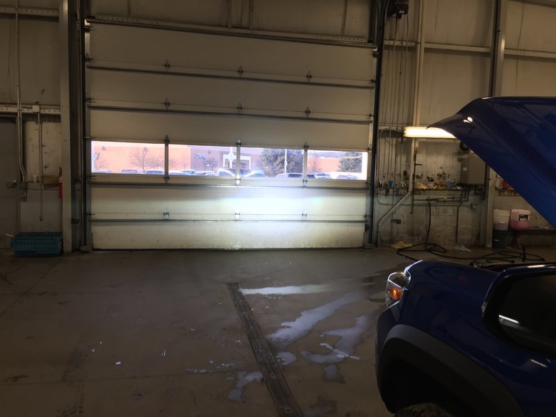

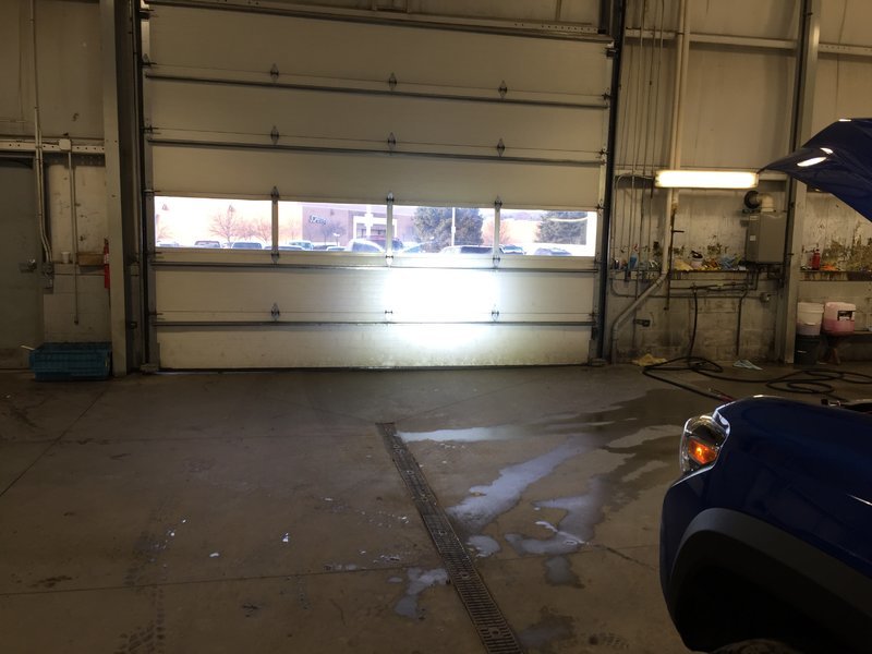

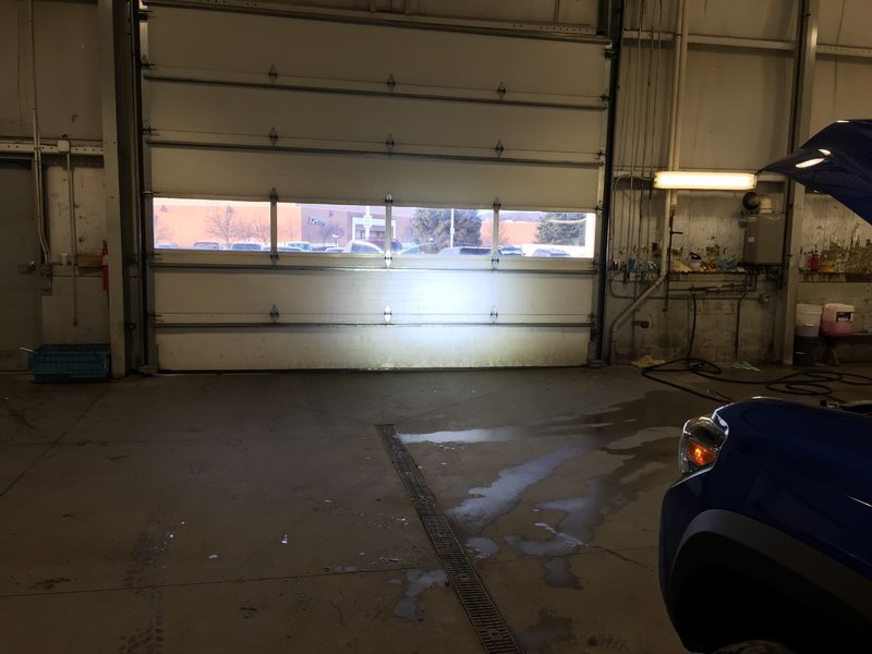

    Got it installed this morning. Cali raised bar with Chris's mounts fit like a dream
    55w HIDs and light bar
    Light bar only.

    Yes. Mine is a flush mount. Took a little cutting.
